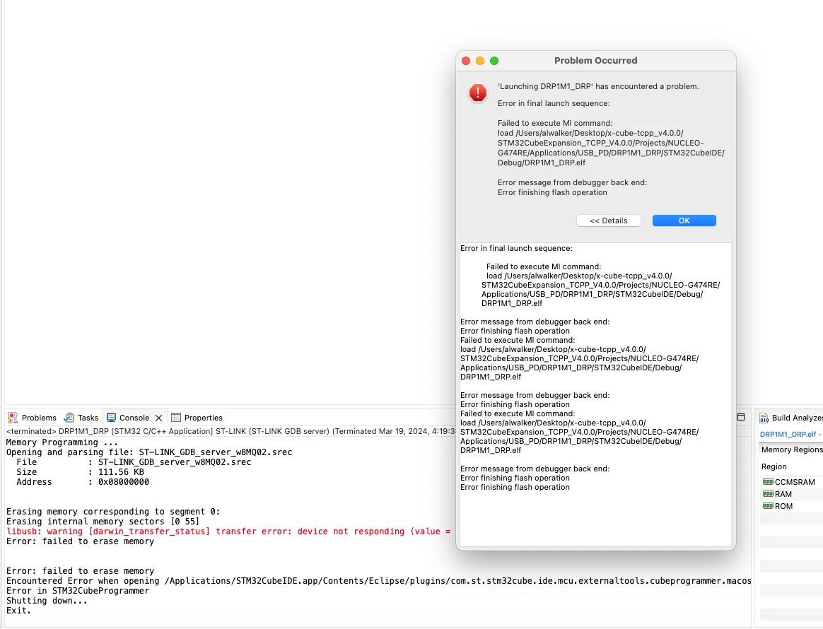

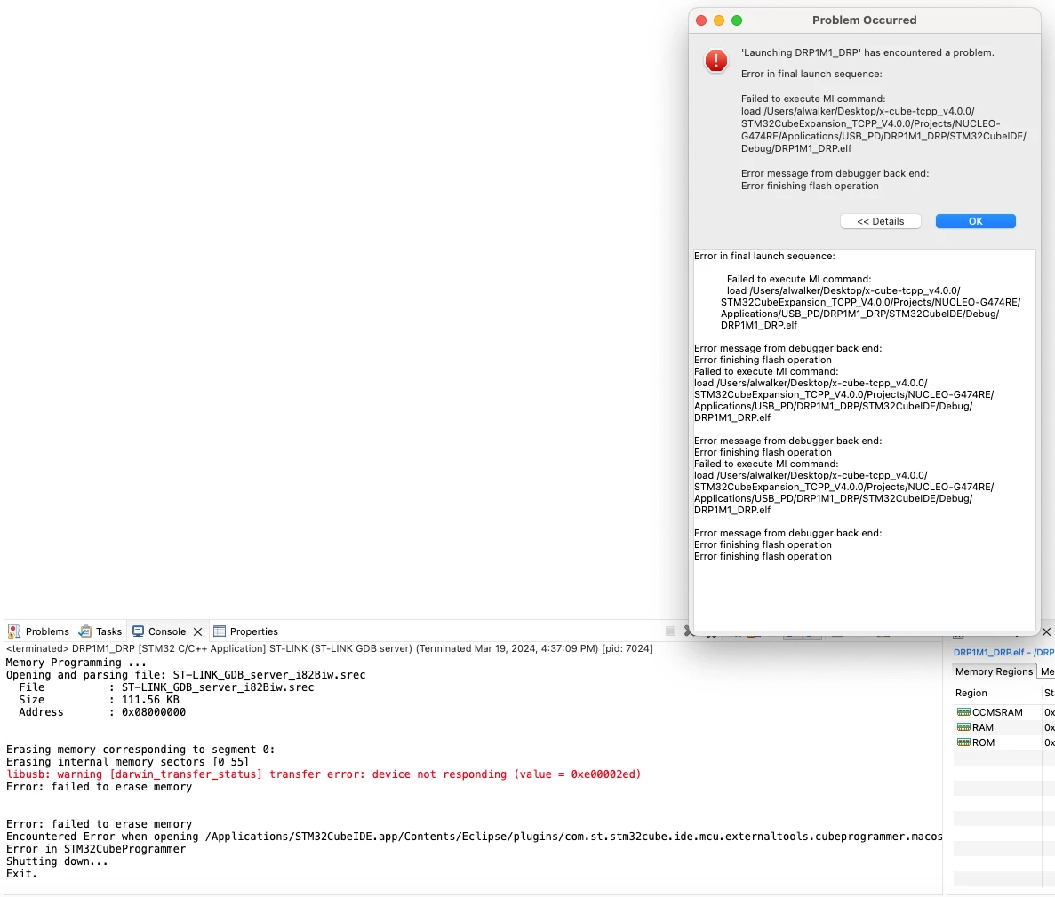

I have successfully built the DRP1M1_DRP Dual-Role USB-C project targeting the NUCLEO-G474RE (supplied with X-CUBE-TCPP v4.4.0). The first time I tried RUN, I had to update the ST-LINK software on the NUCLEO board (it's brand new), but having done that when I try again I get the attached error saying:
Error finishing flash operation
Please see attached, any ideas please?

     @alw Would you please insert a hub between USB-C adapter's plug and the board and see if the issue persists?

    I've attached a screen capture showing the error more clearly. I'm using a current model MacBook Pro with an Apple USB-C to USB-A adapter, and then a USB-A to Micro-B cable. Is there any known reason why this wouldn't work please?

    Problem solved, ST-Link doesn't like the Apple USB-C to USB-A adapter. If I use the USB-A hub on my monitor then it works.

    Yes, when I insert a bus-powered USB hub in-between the Apple USB adapter and the STM32 NUCLEO board, the downloading works ok
