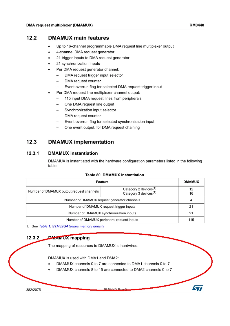

Anyway, here is what I think should work, but I don't have a G4 to test it. I've omitted GPIO pin setup, set them to outputs in GPIOA->MODER.
1. Make sure that all peripherals used (GPIO, TIM, DMA and DMAMUX) are enabled in RCC.

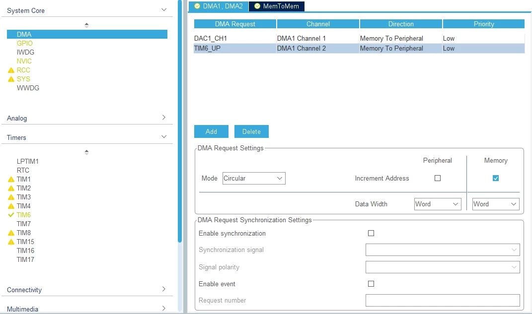

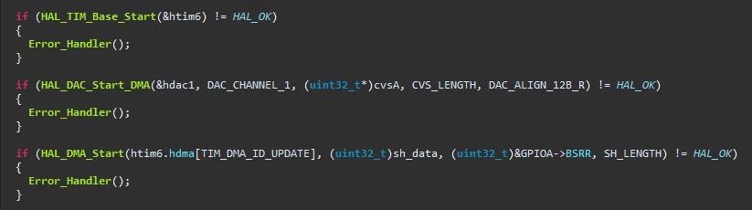

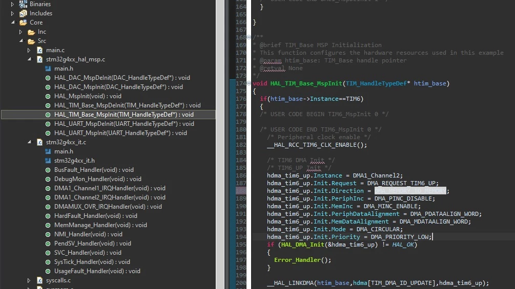

1.) Add DMA to TIM6 (which is also controlling a DAC simultaneously):0690X00000DXsclQAD.jpg
2.) Change the setting for the timer DMA in the auto-generated code to use DMA_MEMORY_TO_MEMORY rather than DMA_MEMORY_TO_PERIPHERAL:
3.) Start the transfer writing to GPIOA->BSRR:0690X00000DXss0QAD.jpg
And this frankenstein solution, which obvious gets nuked when you regenerate using a new .ioc due to modifying a generated function, ALMOST works.
I get one of the GPIOA pins changing, but at approx 3 times the rate I would expect.
So I think going back to custom functions is the way to go as you've outlined above.

After reading the STM32G4 ​RM0440 guide I found that circular mode doesn't work for memory to memory DMA, which is a shame since I want to output address data for a multiplexer simultaneously to outputting DAC data. Circular mode would have been perfect since the GPIO address sequence is always the same. I'll just have to find another way.
waclawek.jan
Feb 29, 2020 9:21 AM UTC
You probably don't want M2M DMA. It differes from M2P and P2M transfers only in that it does ignores any external "trigger" (request) and self-triggers transfers if NDTR is not zero. This is why it does not allow circular transfers - it would flood the buses and probably kill other DMA transfers (pending priority etc.)
Simply use any of M2P or P2M triggered e.g. by timer, and then set the GPIO address as the destination address, i.e. if you chose M->P, set GPIO as peripheral address.
As berendi already hinted, Cube/CubeMX is inevitably constrained only to the "normal" cases, so as soon as you want anything less usual, it starts to get in your way.

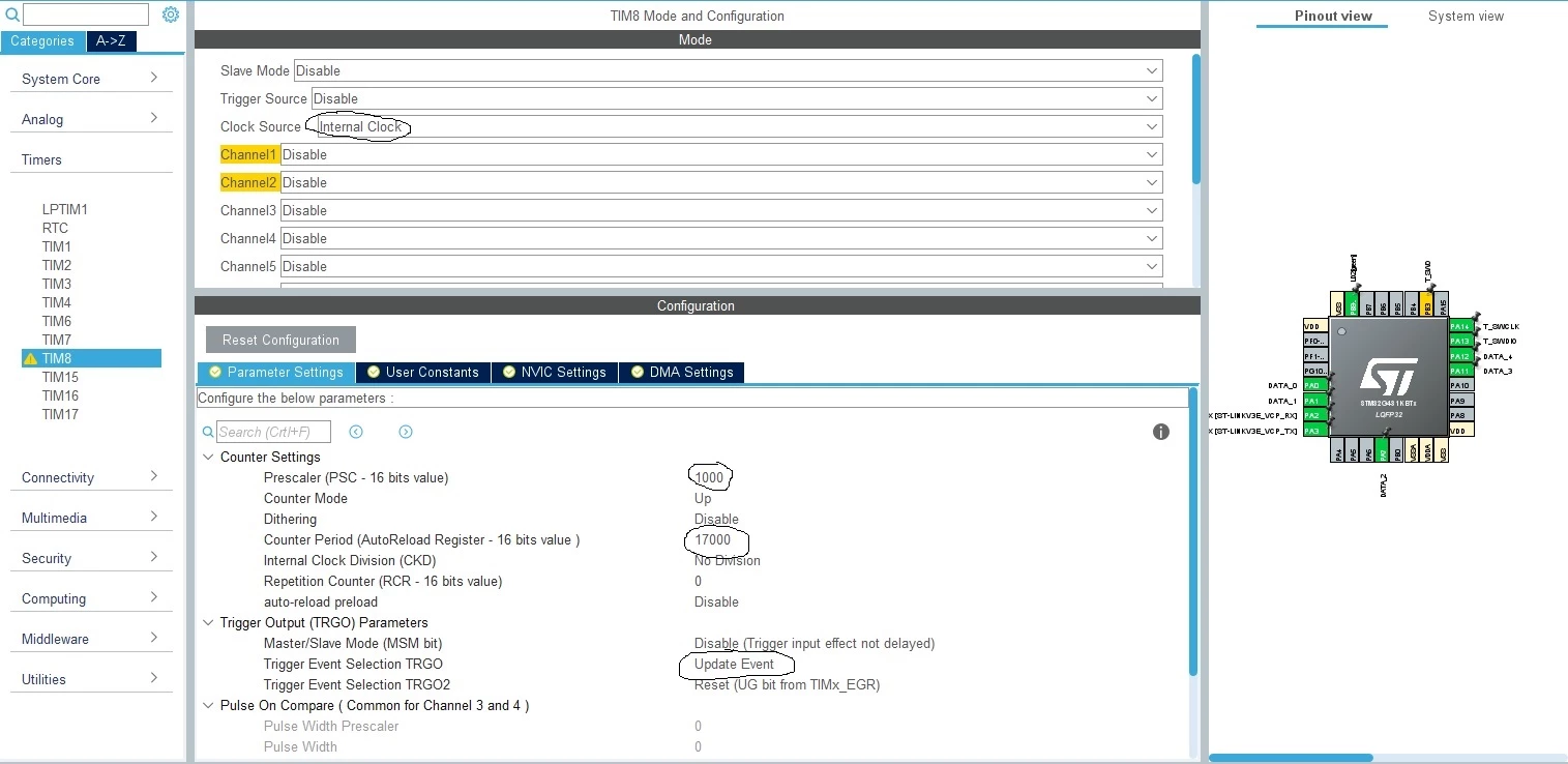

TIM8 set up as the timer:

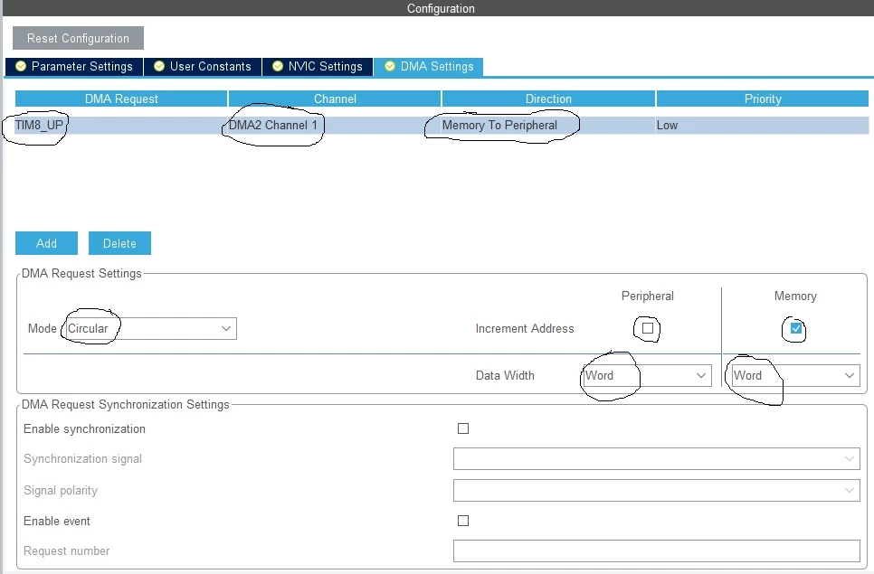

DMA is set up to be triggered by TIM8 UP, in circular memory to peripheral mode:

OK managed to back-port this solution into the HAL also, like so:
 if (HAL_DMA_Start(&hdma_tim8_up, (uint32_t)gpio_data, (uint32_t)&GPIOA->BSRR, GPIO_DATA_LENGTH) != HAL_OK)
 Error_Handler();
 __HAL_TIM_ENABLE_DMA(&htim8, TIM_DMA_UPDATE);
 if (HAL_TIM_Base_Start(&htim8) != HAL_OK)
 Error_Handler();
The trick is to note that the HAL never defines:
Which effectively sets:
TIM8->DIER = TIM_DIER_UDE; // enable DMA on timer update (overflow)
Which makes it all work.
waclawek.jan
Mar 3, 2020 12:43 PM UTC
Thanks for coming back with the solution.
> The trick was to use DMA2, and the correct MUX entry (turns out DMAMUX1 channels 0-5 are only for DMA1 and 6-11 only for DMA2).
This clearly contradicts to RM0440:
Probably this info has to be split according to the cathegory of the devices.
@Imen DAHMEN​  can this please be fixed in RM0440.
@Vincent Onde​  in https://www.st.com/en/microcontrollers-microprocessors/STM32G431VB.html# folder I can't see any AN related to DMA, yet alone to DMAMUX, where this information ought to be detailed, too.
Can you please also confirm this:
> Also only DMA2 seems to work with GPIO, which is not what R0440 suggests (it shows a dense connection, but that's not the case).
Thanks,

waclawek.jan
May 15, 2020 2:07 AM UTC
> DMA1 doesn't seem to be able to be MUX'ed to AHB2 peripherals.
How do you know?
Can you open a new thread with this, please? (giving link to this one perhaps)
etheory
etheoryAuthor
Senior
May 20, 2020 2:07 PM UTC
I haven't proved it for anything but the DAC DMA, but the reason I suspect this might be the case is that if you try and use DMA with the DAC's on DMA1, it simply doesn't work. To get it to work you HAVE to switch to DMA2. This is interesting, because RM0440 page 82 shows that the DACs are AHB2 peripherals.
Happy to open a new ticket for this. Thanks.
