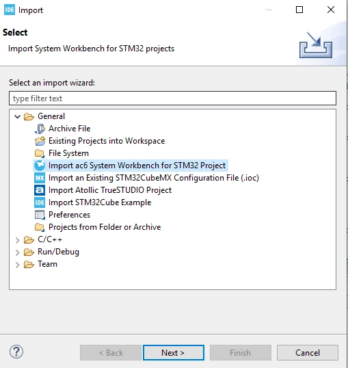

Nucleo_F429ZI Ethernet echo example
I'm new to STM and finding the mash-up of tools and examples quite frustrating.
I purchased a Nucleo_F429ZI with Ethernet and there only seems to be one Ethernet example in the driver repository "LwIP_HTTP_Server_Netconn_RTOS". We wanted to use the TCP Echo client without RTOS, but that seems to be missing.
Also none of the examples seem to be geared around there own STM32CubeIDE ?
Can anyone help ? I would like to be able to use the CubeMX tool for chip setup and have a working example of the TCP Echo client without RTOS, so i can use as a platform to develop off of.
Should I move away from the STM32CubeIDE ?
any help would be much appreciated....

Hi Justin,
Did you solve your problem? I´m with the same problem.
Do you suggest other board that have support to ethernet socket?

Have you got a try to STM32Cube_FW_F4_V1.25.1\Projects\STM32F429ZI-Nucleo\Applications\LwIP\LwIP_HTTP_Server_Netconn_RTOS ?
Ok SW4STM32 based example but such is fully STM32CubeIDE supported. Just rely on proper import feature and you're done:
