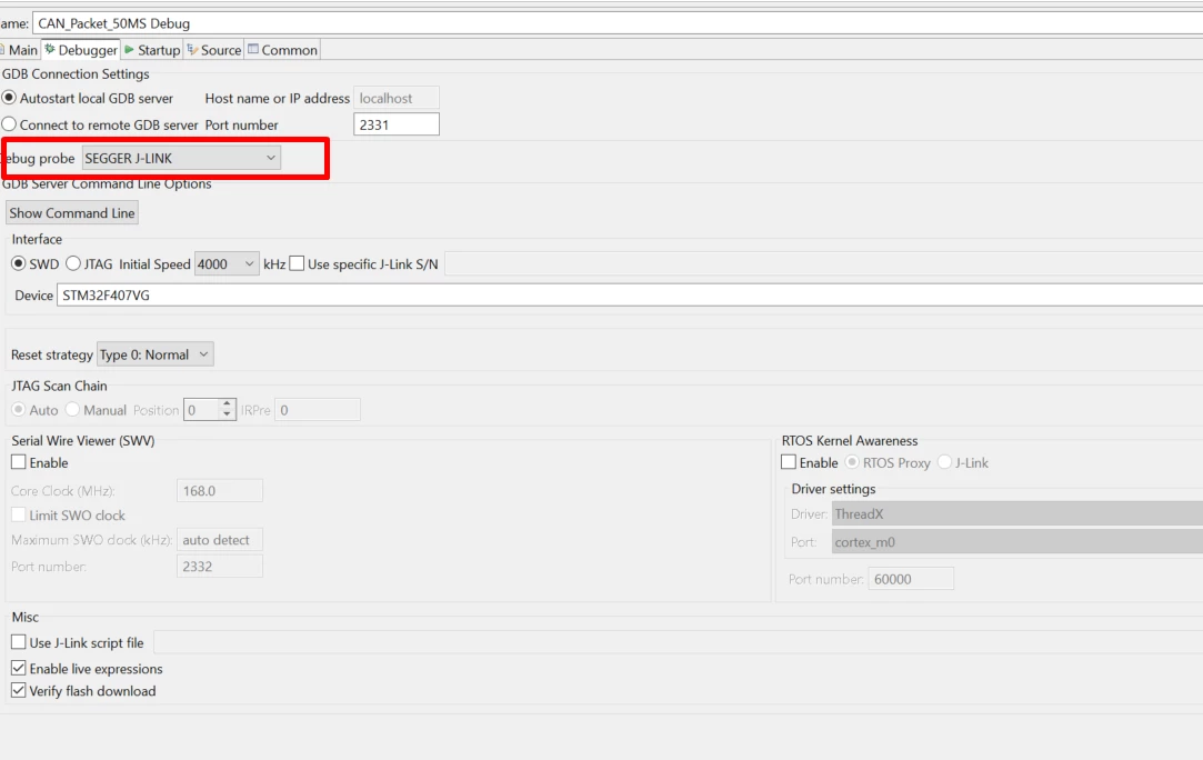

I would like to use SEGGER System View. In order to achieve that I need to convert ST-Link to J-Link firmware. have followed instructions here.
Then, I have performed below configuration.

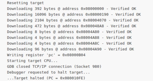

In order to make sure whether conversion is OK or not, I flashed my application via J-Link. Please see the console output attached.
I can not see that my code is run on the board.

    AScha.3
    seems ok to me :
    program..verify...ok.
    + halt target.
    So you need to "run" in debug or try reset-button to start cpu again.
