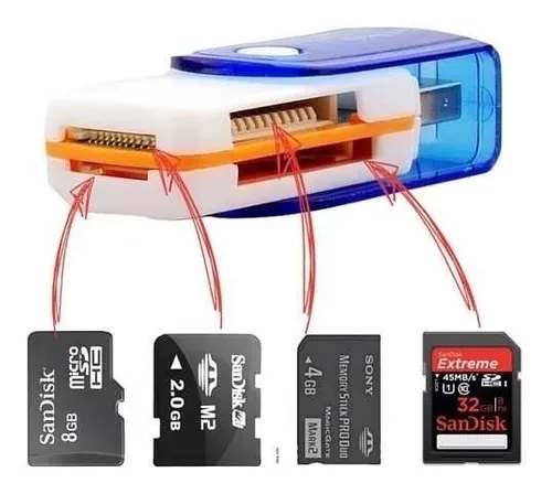

August 21, 2020
No, I just assembled the code with the two ports to test, I am using only one port at a time to test. I'm testing with an adapter of this type:
https://www.dx.com/p/4-in-1-usb-20-rotatable-memory-card-reader-micro-sd-card-adapter-for-tf-sd-m2-ms-card-2041806.html

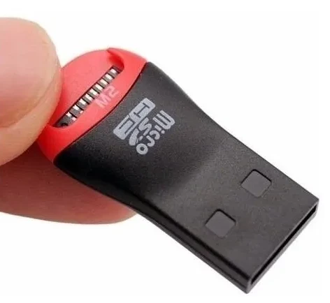

August 21, 2020
The same thing happens with this other adapter model:
