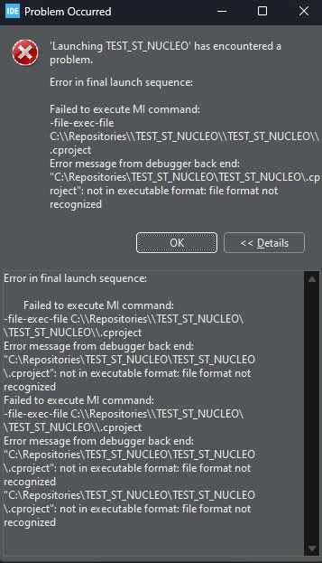

Hello all,
I have created a project with STM32CubeMx based on this evaluation board:
I generate the source code, and I  can compile it correctly from STM32CubeIDE.
The problem is when I try to Run or Debug it, I get this message:
If anyone can help me I would appreciate it.
Much thanks in advance.

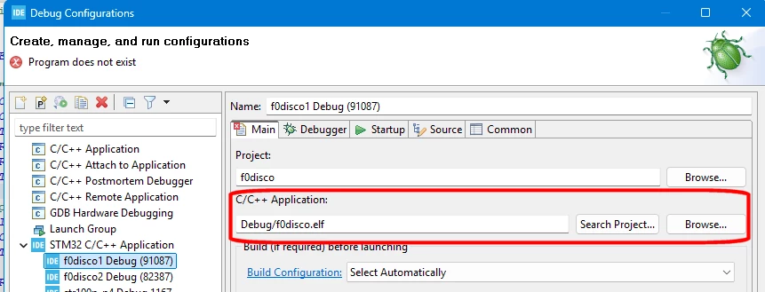

Andrew Neil
February 2, 2026
It looks like your Debug Configuration is wrong - it is trying to use .cproject as the executable.
The executable name should be <project-name>.elf
PS:
Like this:
