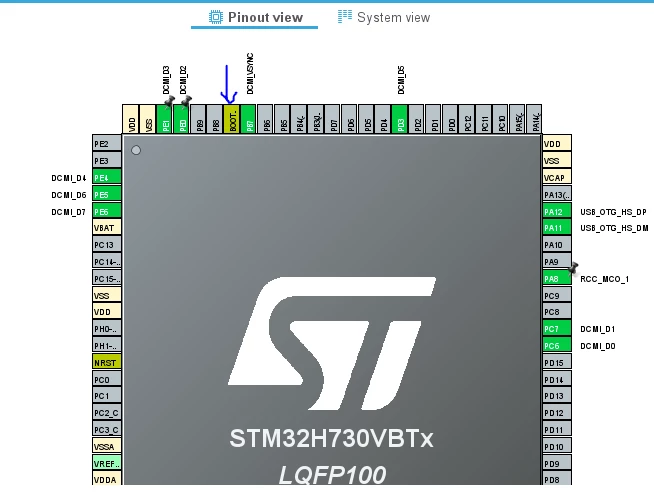

Not able to see the STM32H730 USB virtual port number under "ports" of the Device manager in Windows.
In debug mode able to see the com port number in device manager under ports, Once debugging mode is terminated unable to find the Virtual comport in Device manager. What could be the problem, is any configurations missed ?

Custom board?
Have you left BOOT0 floating,or pulled high?

It's a In-house Cutom board and BOOT0 pin is at Rest state.
What should be the state of this pin to detecting Virtual port.
Please see the attached picture for BOOT0 pin status

Try driving BOOT0 low (On our boards we tie it low, some are STM32H7xx).
In MX may be able to enable a pulldown on BOOT0 pin.
*If uncertain about a pin put places for Pullup and Pulldown resistors on PCB, then can populate later after testing. Leaving input pins floating invites RF noise to randomly change the pin's state, which means it could behave very different "in the field" compared to bench testing.

BOOT0 should never be left floating. Pull it down to GND if you want user code to be ran at startup. There is no internal pulldown so an external resistor is required, or tie it directly to GND.
