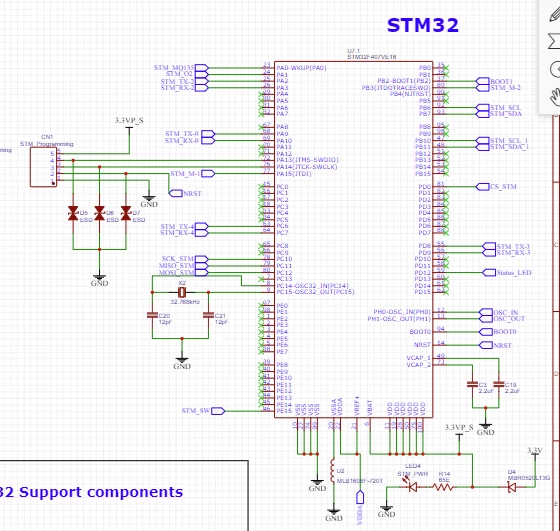

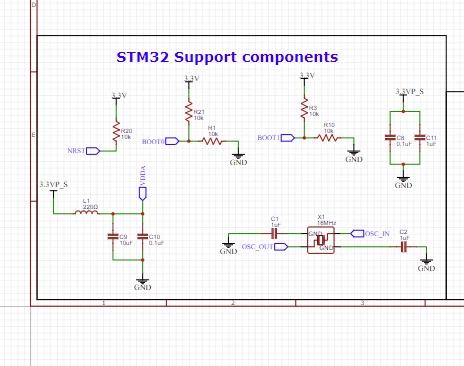

I built a custom board and attempted to program it using both the ST-Link Debugger V2 and an STM Dongle, but I'm encountering issues and can't seem to program it successfully.
Could anyone suggest what the problem might be?

    1. put a cap on nrst, 100nF maybe.
    2. connect under "software reset"
    And tell..

    Andrew Neil
    So both a genuine ST-Link, and a fake/clone ?
    More details would help!
    What "issues", exactly?

    suhasAuthor
    @AScha.3
    Thankyou so much it worked i am able to program.
    again thanks a lot.
