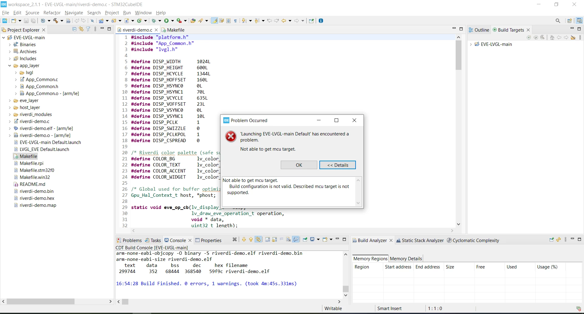

I’m trying get Riverdi’s LVGL demo working.  This is the first time I have ever used STM32, LVGL and Cube IDE - so I’m hoping Riverdi’s video guide has just omitted something simple but crucial!
I’m using:
  • STM32 Cube IDE (v2.1.1)
  • ST-LINK V3SET (firmware version V3J17M10B6S1)
  • Riverdi development board (LINK)
  • Riverdi EVE4 7” display (LINK)
I’m following this video guide word for word and I have not done anything whatsoever over and above what is described in the video.
The code seems to build successfully however when I try to debug/run I get the following error message (“not able to get mcu target”), which I assume is the crux of my problem.
I’d really appreciate some help getting over this (hopefully very simple hurdle) so I can start to familiarise myself with STM32 and LVGL.

Hi guys,
Bit of an update for clarification:
I can successfully connect to the ST-LINK V3 and the STM32 Evaluation board using STM32 Programmer, because I can read/update the firmware on the ST-LINK and I can read a bunch of IDs etc from the Evaluation board.  However I still get the same “Not able to get mcu target” issue in Cube IDE when I try to debug or run.

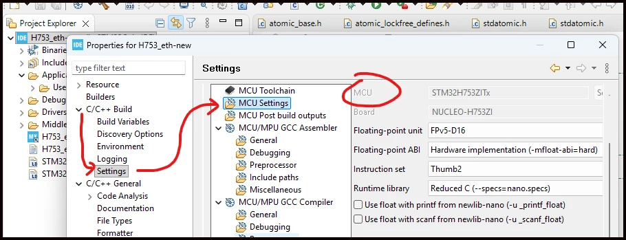

Pavel A.
Jun 16, 2026 5:22 PM UTC
Open the project properties in CubeIDE. What is the MCU shown there?
xxJaRxxAuthor
Jun 16, 2026 7:23 PM UTC
Pavel thank you so much!  It was empty - no MCU selected.  As soon as I selected the correct one it all worked perfectly!
Thank you, I have been struggling with this for days!
