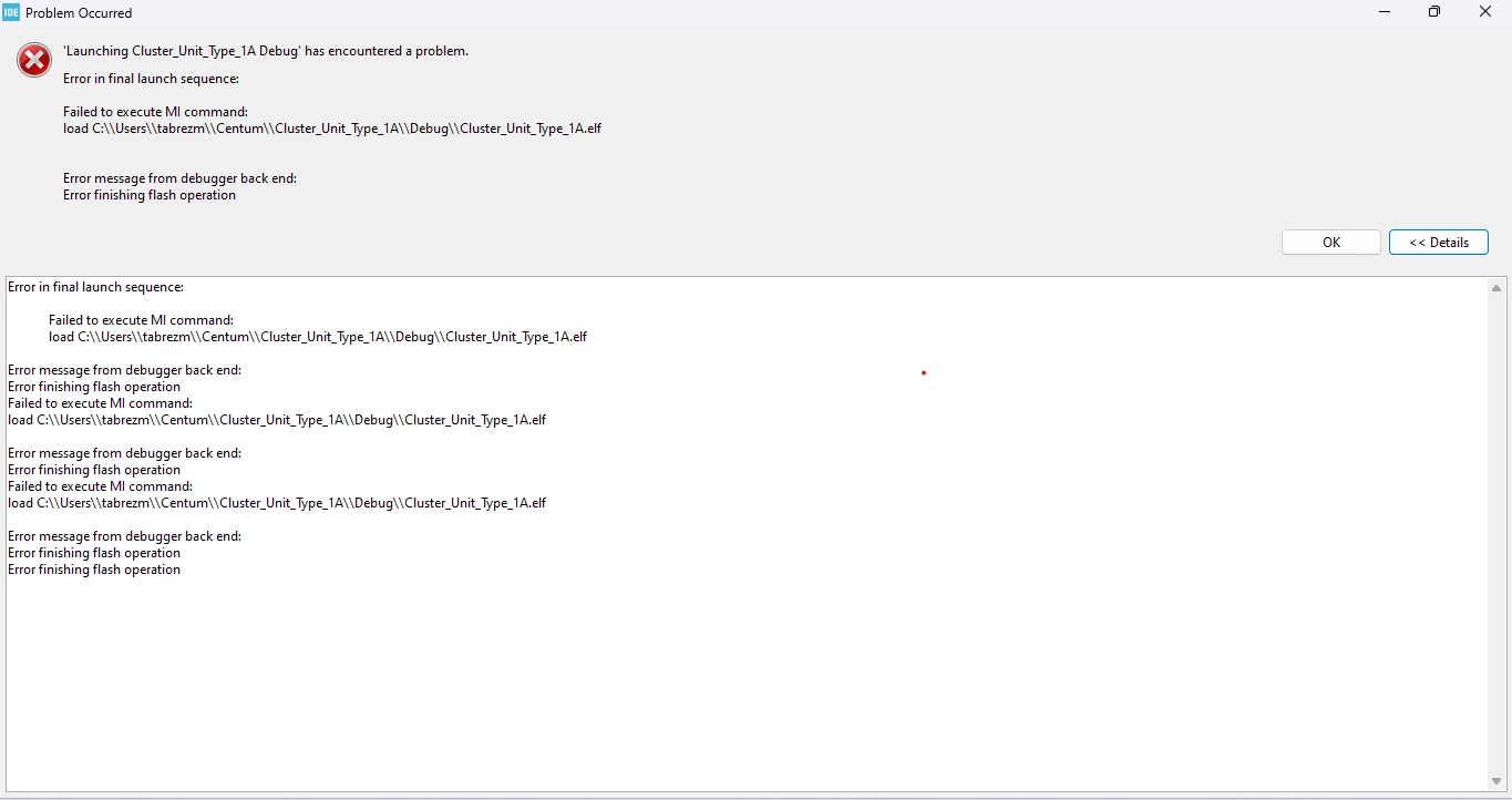

Hi everyone,
We are facing issue is  " Not able to load/dump code via ST -LINK Programmer " and it's showing as error mentioned below. please help us to resolve this kind of issues or please suggest any idea to implement it as soon possible.

Error: No STM32 target found! If your product embeds Debug Authentication, please perform a discovery using Debug Authentication

Error: Data mismatch found at address  0x08000002 (byte = 0x00 instead of 0x08)
Error: Download verification failed
Encountered Error when opening C:\ST\STM32CubeIDE_1.16.0\STM32CubeIDE\plugins\com.st.stm32cube.ide.mcu.externaltools.cubeprogrammer.win32_2.1.400.202404281720\tools\bin\STM32_Programmer_CLI.exe
Error in STM32CubeProgrammer
Shutting down...
Exit.

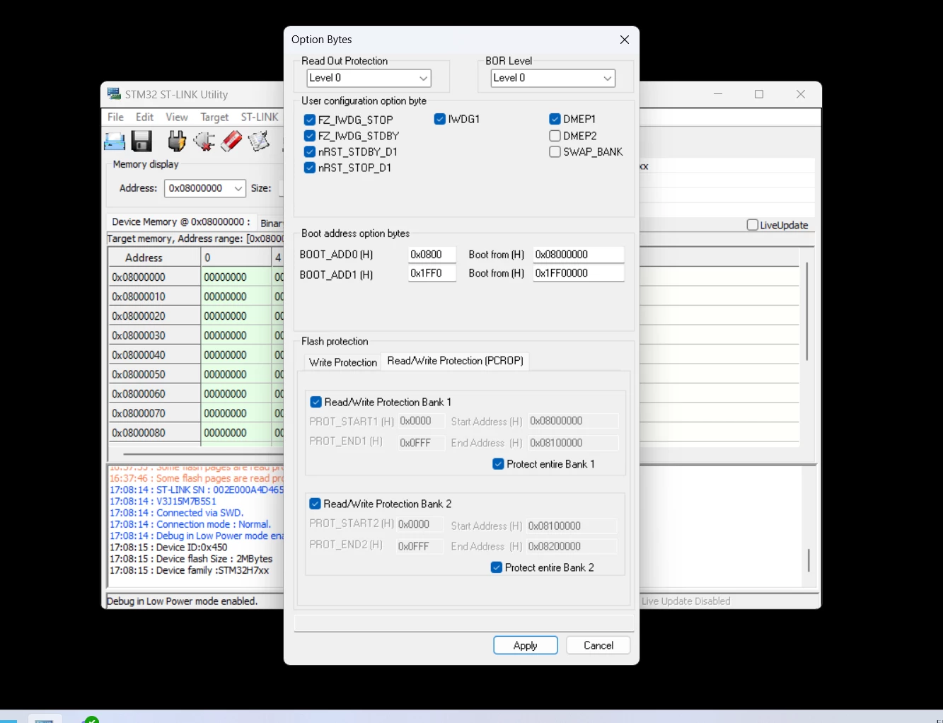

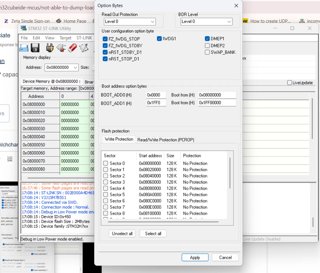

    Check banking in Option Bytes, show options.

     Option Bytes,
