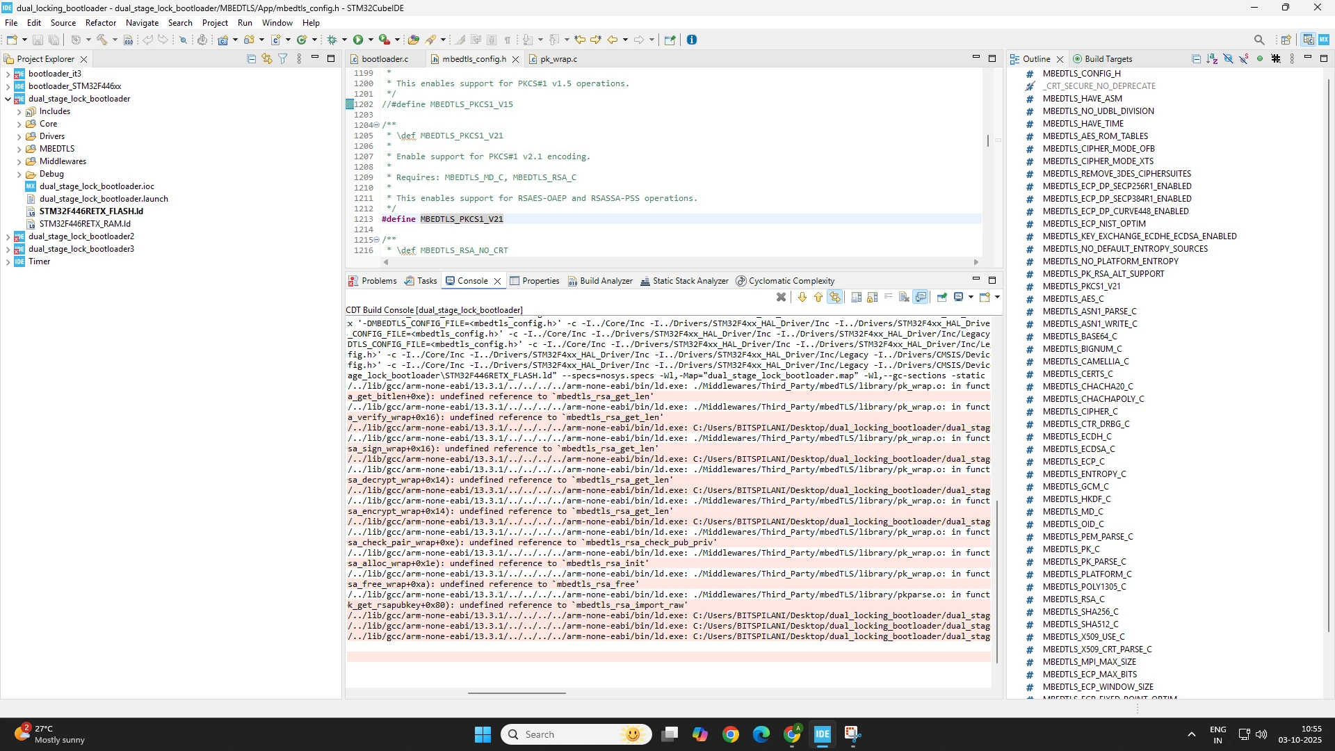

Not able to configure mbedtls in STM32CubeIDE
I want to use the rsa feature of mbedtls but when I uncomment #define MBEDTLS_RSA_C in the mbedtls_config file it is showing undefined reference to mbedtls_rsa_get_len, mbedtls_rsa_check_pub_priv, mbedtls_rsa_init, mbedtls_rsa_free and mbedtls_rsa_import_raw.

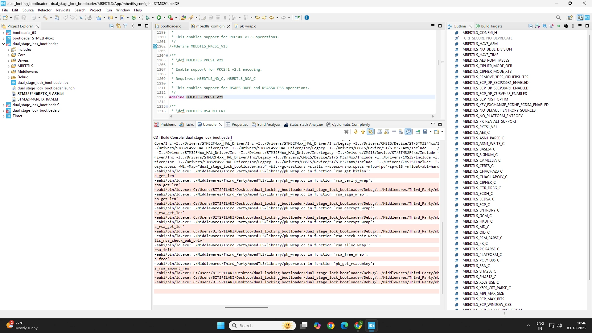

I sincerely apologize ,I forgot to mention the steps I have already taken.
In STM32CubeMX, follow these steps to enable RSA support in MbedTLS:
1- Under Middleware, select MbedTLS.
2- Go to the Module tab.
3- Enable the option Show Advanced Parameters.
4- In the search bar, type MBEDTLS_RSA_C.
5- When you find the MBEDTLS_RSA_C option, set it to "Defined" ( select "Defined" from the dropdown).
Then Go to Feature support tab and change the value of MBEDTLS_PKCS1_V15 and MBEDTLS_PKCS1_V21 to defined
Generate and build the code : the rsa.c will be added successfully to your project

Ghofrane GSOURI
Oct 1, 2025 11:19 AM UTC
Hello @Advait
After uncommenting the line #define MBEDTLS_RSA_C, I encountered the following build error:
In file included from ../MBEDTLS/App/mbedtls_config.h:3294,
 from ../Middlewares/Third_Party/mbedTLS/library/camellia.c:31:
../Middlewares/Third_Party/mbedTLS/include/mbedtls/check_config.h:511:2: error: #error "MBEDTLS_RSA_C defined, but none of the PKCS1 versions enabled"
 511 | #error "MBEDTLS_RSA_C defined, but none of the PKCS1 versions enabled"
To resolve this issue, I also uncommented #define MBEDTLS_PKCS1_V21 in the configuration file.
After making this change, the build completed successfully  I did not encounter any undefined reference errors.
THX
Ghofrane
AdvaitAuthor
Oct 3, 2025 5:17 AM UTC
Hello @Ghofrane GSOURI
I uncommented #define MBEDTLS_PKCS1_V21 but its giving this build error.
AdvaitAuthor
Oct 3, 2025 5:18 AM UTC
I am not able to enable features using the GUI
