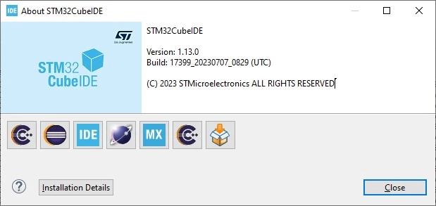

I'm using the NUCLEO-H753ZI, with the STM32CubeIDE development tool (Version: 1.13.0, Build: 7399_20230707_0829 (UTC)).

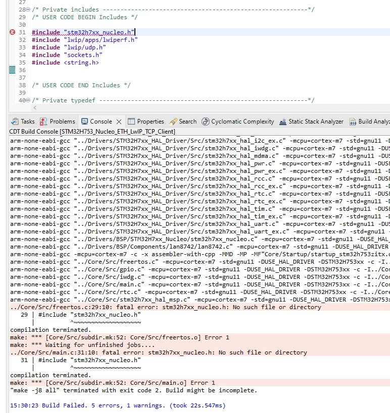

While trying to build the project  - I'm countering the "No such file or directory" error even though the path is included!! see attached pictures.
The error sometimes happens, and sometimes not.
My project is Pure C - no C++ involved.
Before I moved to version 1.13.0 - it worked well on 1.12.0 (the error happened, but it was very rare).
Please assist - Thanks!

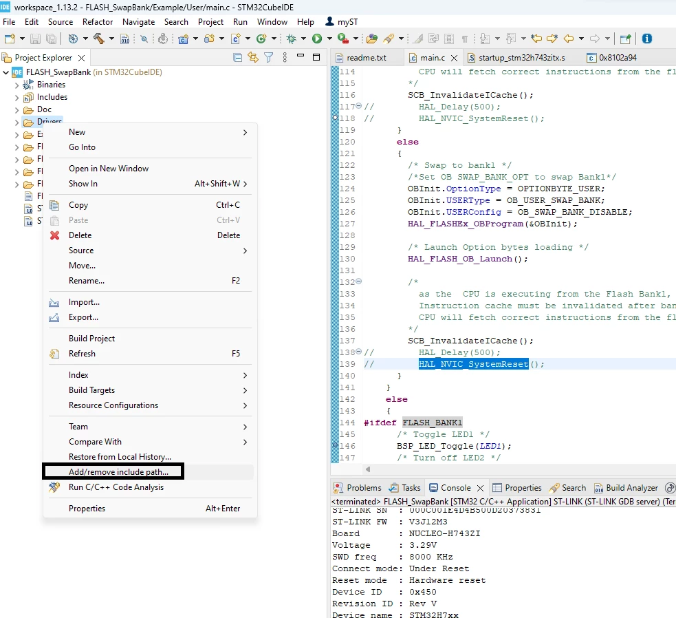

    November 12, 2023
    Solved the problem by including path - using the "Add/remove include path..." option:
