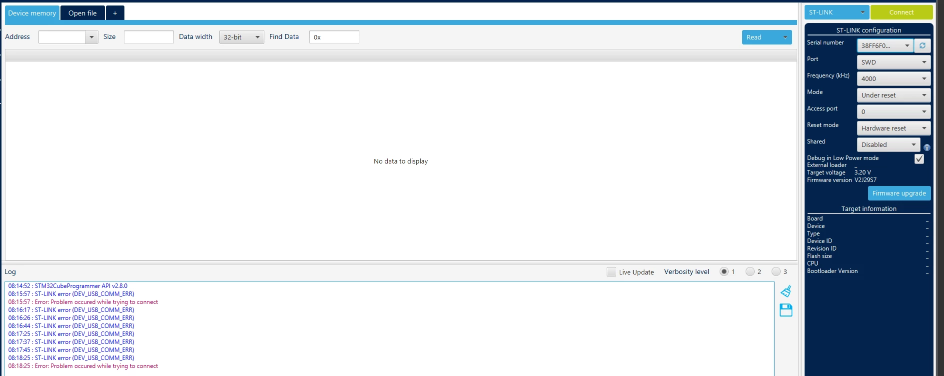

FranzCreva
Hi DeLorean,
The error I receive via STM32CubeProgrammer is the following: DEV_USB_COM_ERR.
I opened the program, I saw that ST-LINK was already selected and I tried to Connect to the device, but I received the first error.
I then disconnected the ST-LINK to the MCU and tried to refresh the ST-LINK list and it detected that there was no ST-LINK connected. Tried unplugging the USB and plugging it back in but nothing worked. This a couple of times.
After a while it detected the ST-LINK, I tried to connect to the MCU and it gave me the same error.
The ST-LINK is not seen by any program, not even the old STM32 ST-LINK Utility.
They always worked before

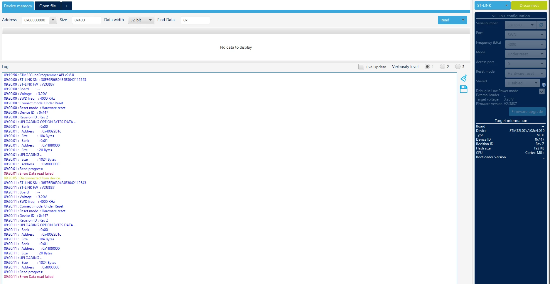

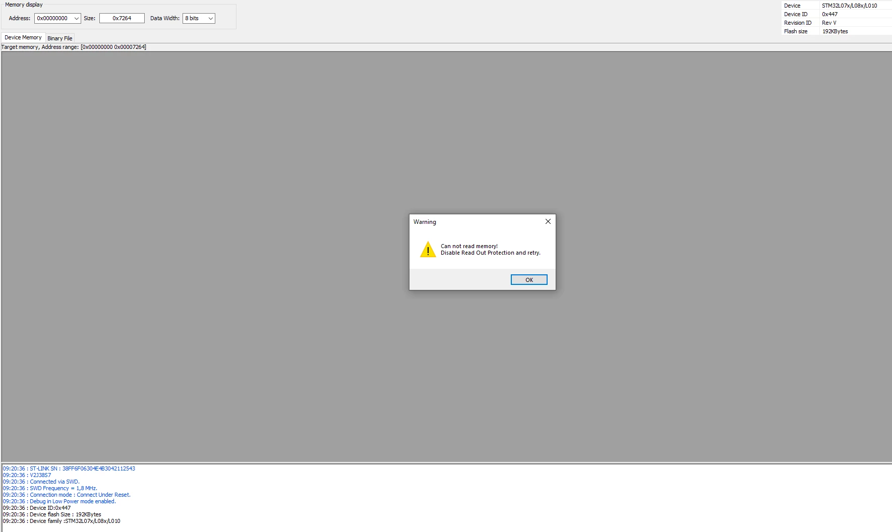

FranzCreva
One thing I have now noticed is the fact that on STM32 Cube Programmer I get the Data Read Failed error when the MCU has active protection, while the STM32 ST-LINK Utility gives me the correct message.
It is incorrect for the STM32 Cube Programmer to indicate an error, correct?
