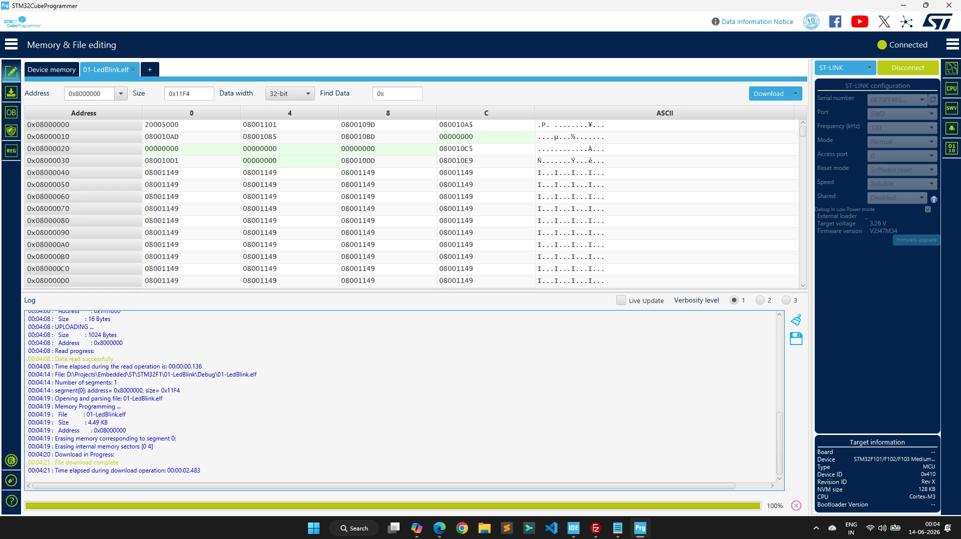

But when I used the STM32CubeProgrammer, and programmed the same binary generated by STM32CubeIDE, it works fine, i.e. programming works fine, as can be seen below.

  • ST-Link works fine with STM32CubeProgrammer

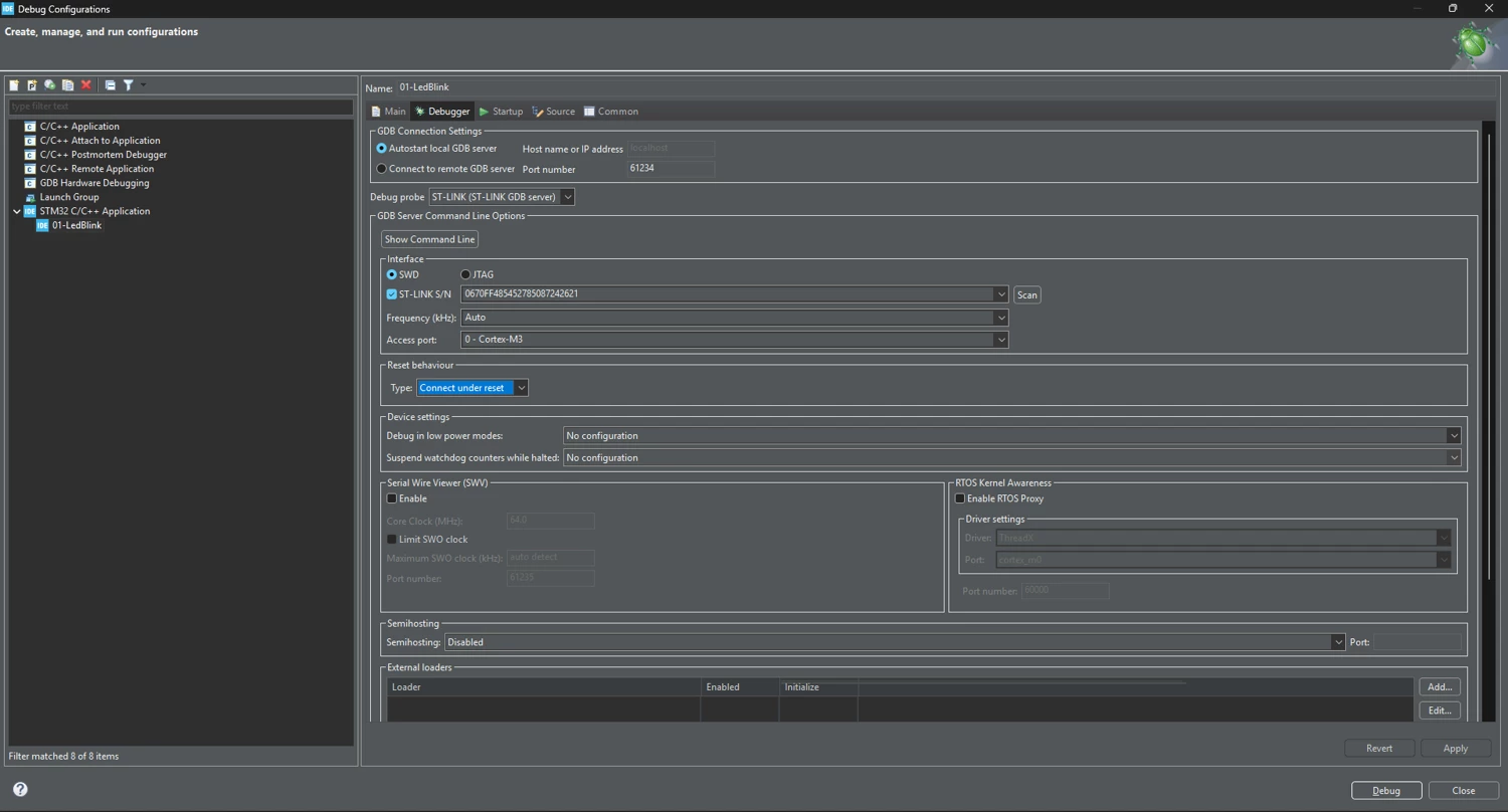

Just try :
  • deselect the fix “st-link SN” .
  • connect with : software reset

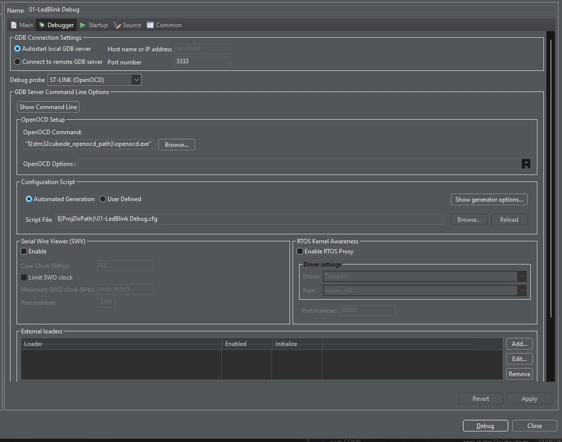

  • select debug mode : openOCD , not ST-GDB
xpress_embedo
Jun 14, 2026 3:59 AM UTC
When I selected the OpenOCD, the other two options disappeared, and it is still not working, with same message.
AScha.3
Jun 14, 2026 7:12 AM UTC
Did you adjust the -> generator options?

Did you try unchecking the option for the fixed serial number - as ​@AScha.3 suggested ?
Your first screenshot says “ST-Link firmware verification” - so have you tried updating the ST-Link firmware ?
