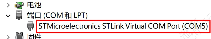

Hello, I bought a NUCLEO-F446RE Evaluation board last month. But it doesn’t work when I “RUN” or “DEBUG” in STM32CubeIDE2.1.1 environment . To solve this problem, I tried several methods supplied by GPT, I can list more information below:
Firstly, my computer is a  lenovo notebook with win11, the STM32CubeIDE version is 2.1.1, and STM32CubeProgrammer version is 2.23.0;

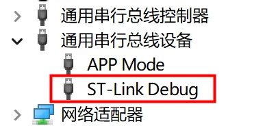

Secondly, the device management can list the key information showed below when I connect NUCLEO-F446RE:

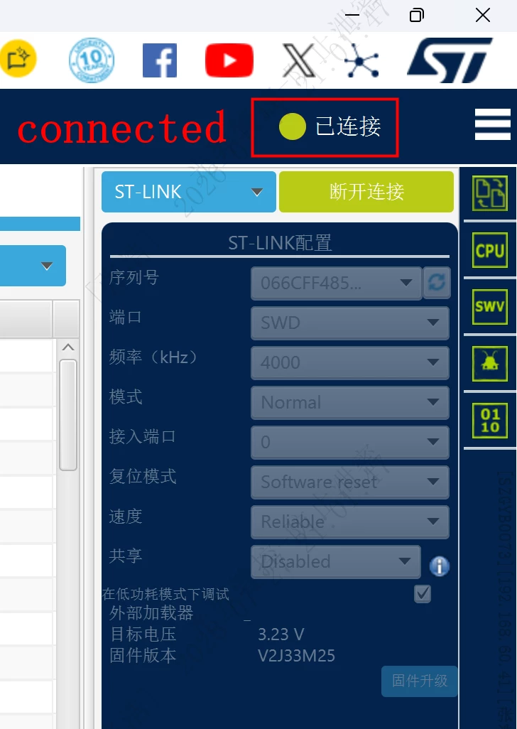

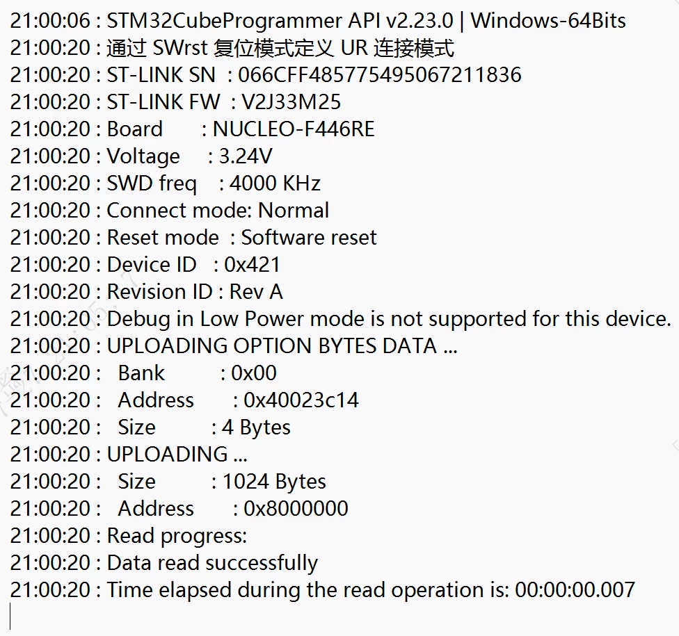

Thirdly, the STM32CubeProgrammer can easily connect NUCLEO-F446RE, the figure of connecting status and log are showed below:

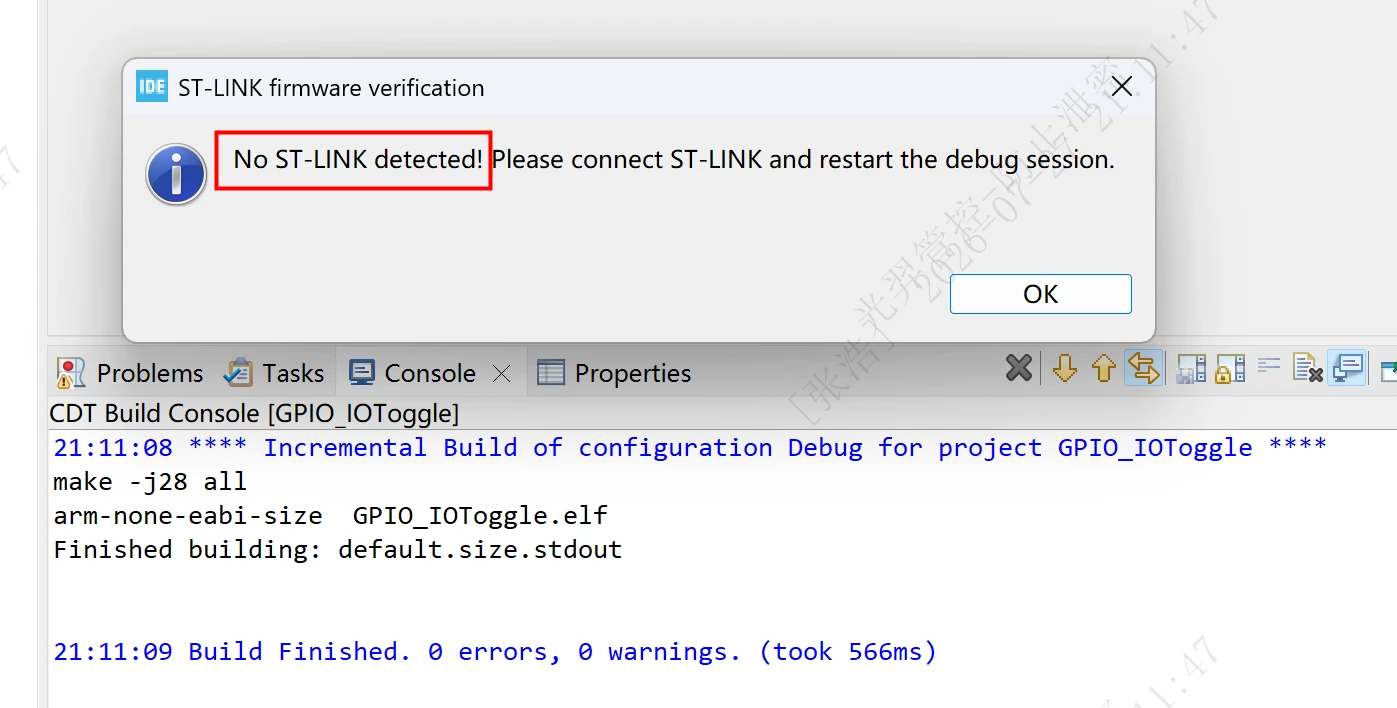

 However, after I closed STM32CubeProgrammer and open  STM32CubeIDE, when I click “run” or “debug”, IDE cannot connect NUCLEO-F446RE, the problem figure showed as below:
I feel puzzled on this issue, can you give some advice? Thanks.

Are you sure it is a genuine ST-Link?
Is Device Manager  still showing the ST-Link as present?
Pavel A.
Jul 28, 2026 10:39 PM UTC
By the serial number the ST-Link looks good.
Just be sure that you fully disconnect CubeProgrammer before trying to connect CubeIDE. Only one program can connect to ST-Link at any time, and will not find the ST-LINK if it still in use by other app. Unless you use “shared” method, which is complicated.

Thanks for the reply by Andrew and Pavel. It really took me too much time on this problem.
I changed a PC and install these software again, the result is positive, ST-LINK can connect now, and also success to  erase, download fw etc…
