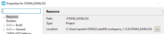

SPaul.5
SPaul.5Author
Mar 9, 2023 2:54 PM UTC
Here is the path of the project but there is no spaces.
0693W00000aIaz0QAC.pngThanks.

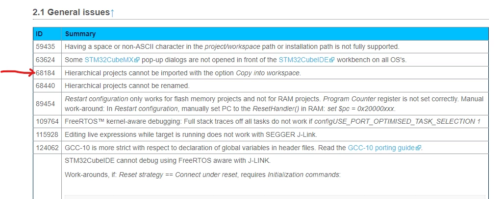

MHoop.1
Senior
Mar 10, 2023 9:43 PM UTC
FYI, just saw this on the STM32VubeIDE wiki.
Wijeden RHIMI
Mar 13, 2023 10:03 AM UTC
Hello ,
Consult the Stm32CubeIDE User Guide chap 2.10 not 2.1 or simply search on import existing project.
You can import a project as written on STM32CubeIDE User Guide without check "copy into workspace" : Because this option breaks a lot of links. The example projects usually have paths outside of the specific example, so when you try to build it can't find all the paths and throws an error.
