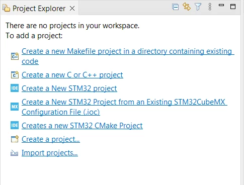

Newly installed CubeIDE does not see projects in the workspace folder
Installed CubeIDE. I set the workspace folder to the one that contains my projects. CubeIDE says "there are no projects in your workspace".
How can I make the newly installed CubeIDE see the projects that are in the workspace folder?

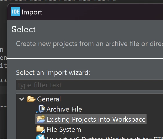

It won't pick them up automatically, you have to import them.
Import -> General -> Existing Projects into Workspace.
