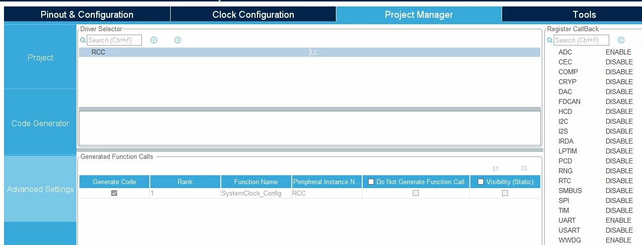

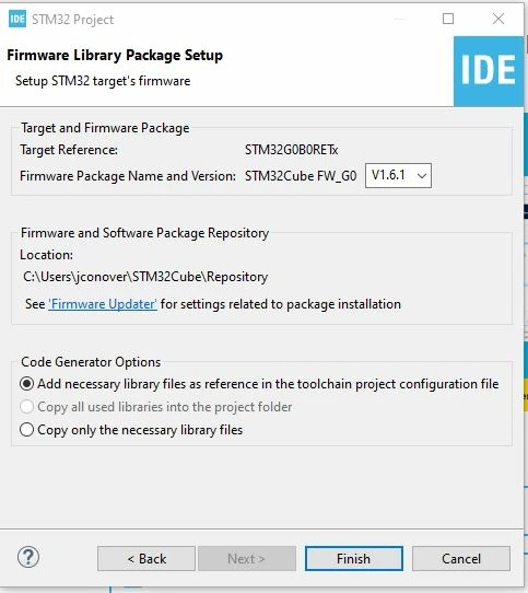

We have an older Cube project from a STM32F0 series that needs to be changed to the larger STM32G0B0 chip. We thought that we would just create a new project with the new micro and port in the older code. When we create the new project there does not appear anywhere in the selection process to have it use the Low Level drivers instead of the HAL.

  • Select 1.6.1 Firmware package.
  • Code Generation Options does not show anything about HAL or LL drivers.
  • Select Finish.
A project has been created where the Drivers directoy has a STM32G0xx_HAL_Drivers directory.
Is there any way to have project creation use Low Level Drivers?

Open the .ioc file by double clicking at STM32CubeIDE and then select project manager -> Advanced settings. There is driver selctor- list where can select HAL or LL driver for each activated MCU block.

Thanks. It's too bad they don't give you the option to use LL from the beginning.
