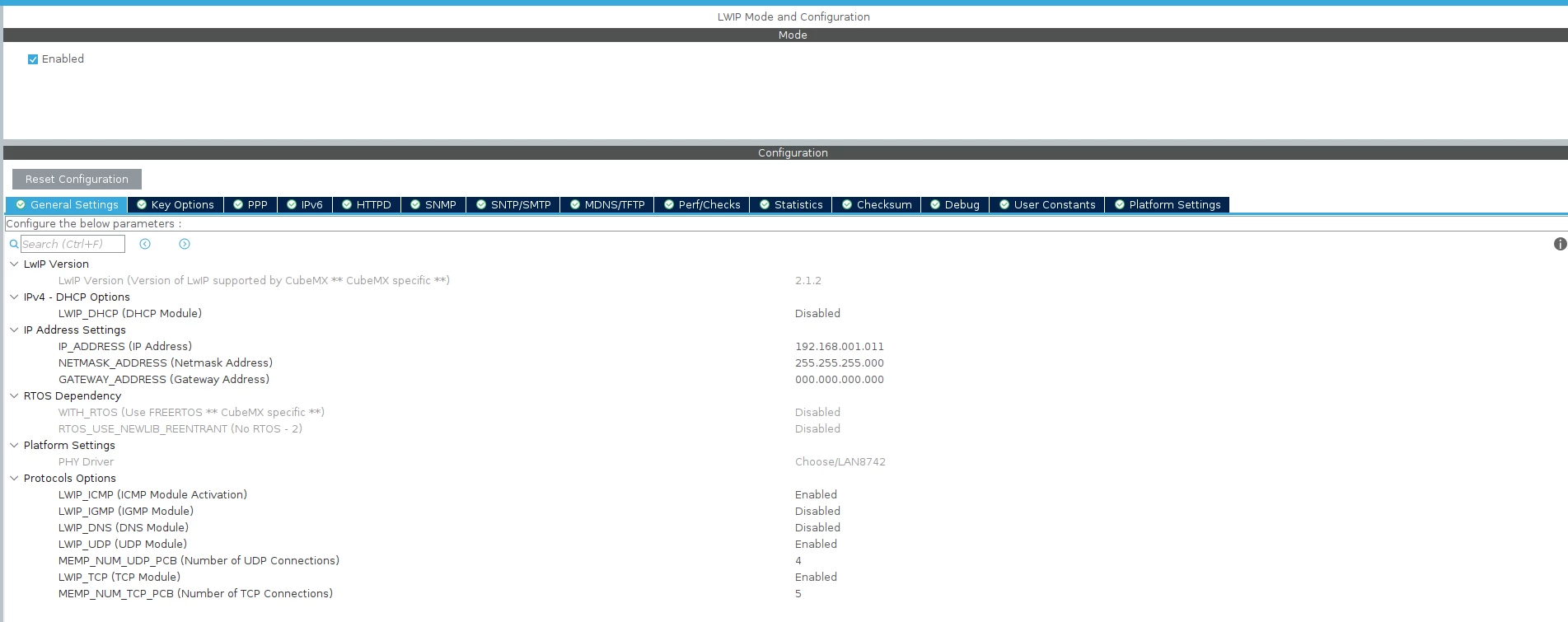

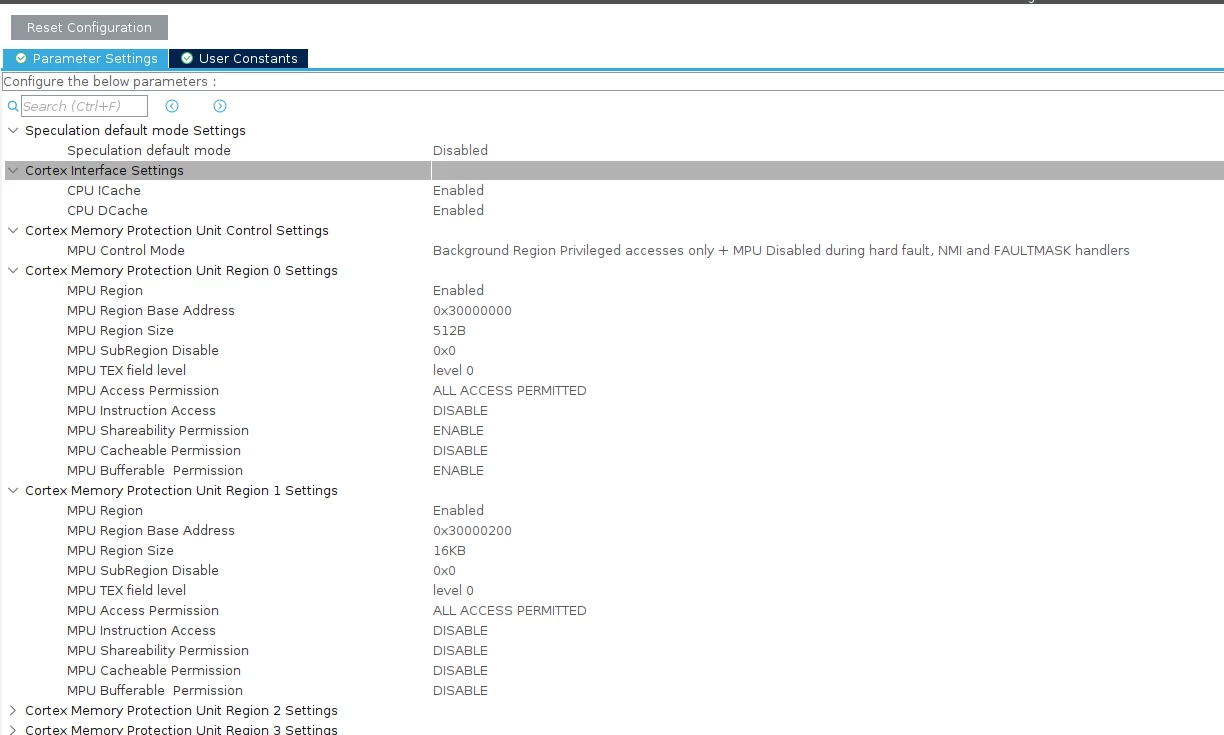

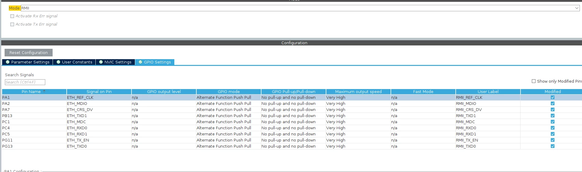

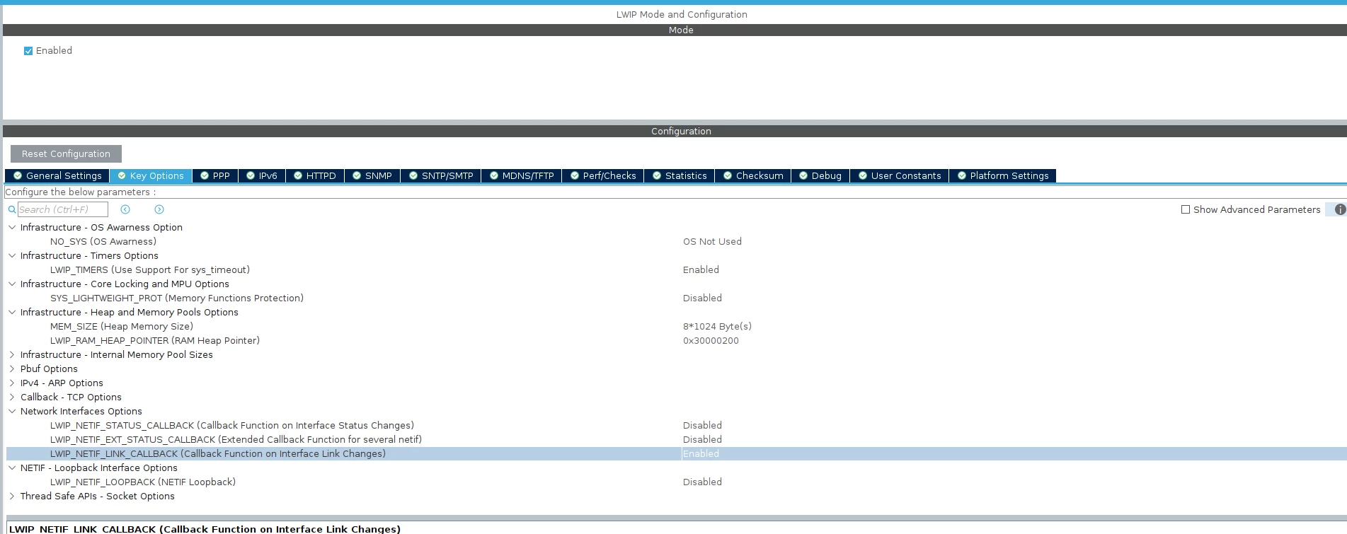

Hello Folks,
I use the H723ZG Nucleo board without FreeRTOS. I had configured Ethernet for the H723ZG in the past. But I am unable to configure it again now, even when following the same steps. When I first got it working, my configuration was based on this Youtube video STM32 ETHERNET #1. Hardware Configuration || PART 1.
In addition, I spent countless days trying to configure the Ethernet without FreeRTOS based on this post How to create project for STM32H7 with Ethernet and LwIP stack working from @Adam BERLINGER . I was able to get it working WITH FreeRTOS, but not WITHOUT it. And I am here to kindly ask for your help.
Here are some screenshots from my `.ioc` file.
I am testing it with the ping example.

Explorer
February 1, 2024
Hi @eduardo_reis ,
Recently I faced similar issue and was unable to establish any communication on this H723 Nucleo board with PC. I tried with LWIP with and without FreeRTOS and also NetxDuo with and without ThreadX. After lot of search I found this project where memory configuration was little different than it was in my previous attempts. Please see the RAM, Rx/Tx Descriptor addresses and MPU configurations from this project. It worked for me and I hope this helps you too.
https://github.com/STMicroelectronics/x-cube-azrtos-h7/blob/main/Projects/NUCLEO-H723ZG/Applications/NetXDuo/Nx_TCP_Echo_Client/README.md
