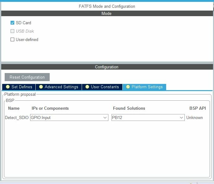

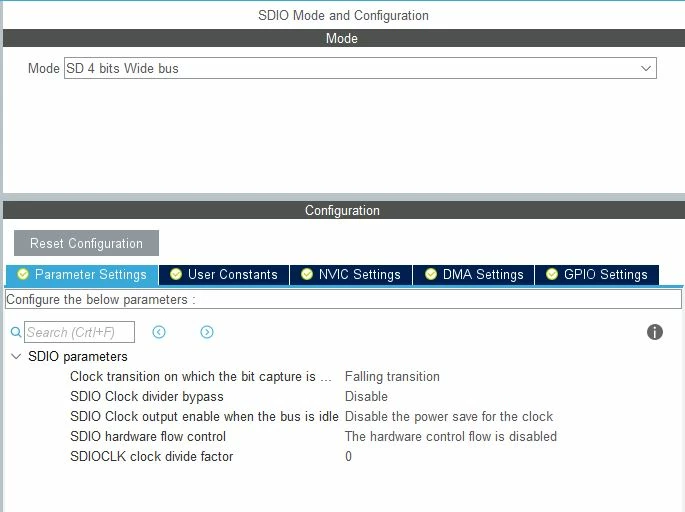

I am trying to use the STM32F405 microcontroller to log data into an SD card using STM32CubeIDE. Specifically, this MCU from adafruit: https://www.adafruit.com/product/4382?gclid=EAIaIQobChMI3qONnpCJ5wIVD_DACh2XCQY7EAAYASAAEgL4QvD_BwE
I found a few resources online and integrated that into the my source code, which can be found in "main.zip". My SDIO and FATFS configurations are shown in the attached figures. I did not change anything under 'Set Defines'.
Regardless of whether I have an SD card in the MCU or not, the results are the same: the program doesn't go beyond the line of code that calls "f_mkfs". I would appreciate it if someone could help me troubleshoot this.

dbgarasiya
Senior
January 22, 2020
you have not enable DMA, for rx and tx also
then try
DLim.16
DLim.16Author
January 22, 2020
Hi Dbgarasiya,
Looks like I can only choose to either use SDIO or SDIO RX & TX but not all three of them, otherwise I get an error say "No available DMA requests for this peripheral".
Was DMA required? I enabled both variations i.e. only SDIO and then only SDIO RX & TX, nothing worked. Let me know if I'm doing something wrong.

I think with all the resources, we are getting close to a solution. Currently, the error I'm seeing is :'FR_NO_FILESYSTEM' whenever 'f_open' is called.
I've reformatted my sdcard multiple times to all kinds of allocation unit settings, that didn't help. Although, when I used 'f_mks', it seemed like it worked, but there was no way of confirming it because when I tried to read the sd card on my PC, the sd card was corrupted and had to be reformatted everytime.
I don't think my sd card is bad because I can actually log data to the it, following the ArduinoIDE instructions by adafruit. So, this implies that something is still wrong/missing with my configurations in STM32CubeIDE.
I have attached my latest version of project. I'd appreciate it if anyone could help troubleshoot.
