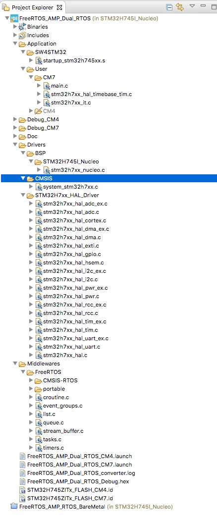

OK, now I want to enable the DAC. From grepping the sources in the project, it doesn't look like the HAL code that was built, presumably by CubeMX, has the DAC set up. (If you suspect I am wrong about this, tell me what I should grep for to disprove it).
How do I ask the IDE to regenerate the HAL code with the DAC drivers present ?
Or, was there some step I could have taken during project setup that would have let me do that customization then ?
TLDR: how do I modify HAL for an example project after it is first built and working, to enable more hardware peripherals?

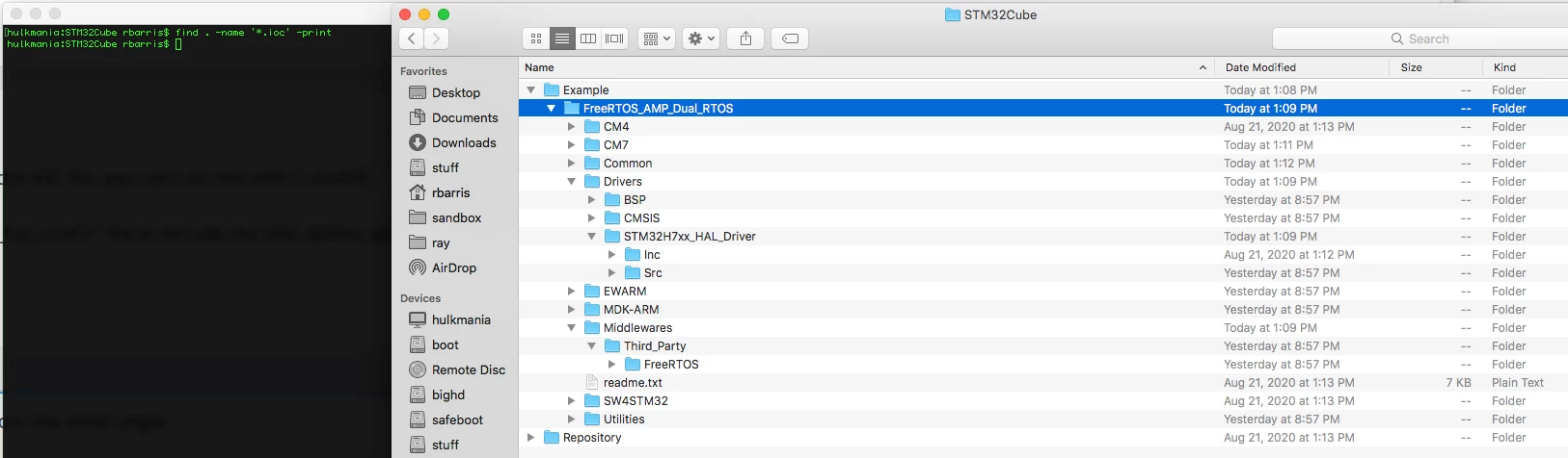

Observation - everything I read about CubeMX involves .ioc files. But there is no .ioc file in the example directory in the IDE workspace (I checked with 'find'). There are a few in the IDE package that match this board:
./Applications/STM32CubeIDE.app/Contents/Eclipse/plugins/com.st.stm32cube.common.mx_6.0.0.202007160824/db/plugins/boardmanager/boards/G71_Nucleo_NUCLEO-H745ZI-Q_STM32H745ZI_Board.ioc
./Applications/STM32CubeIDE.app/Contents/Eclipse/plugins/com.st.stm32cube.common.mx_6.0.0.202007160824/db/plugins/boardmanager/boards/G71_Nucleo_NUCLEO-H745ZI-Q_STM32H745ZI_Board_AllConfig.ioc
./Applications/STM32CubeIDE.app/Contents/Eclipse/plugins/com.st.stm32cube.common.mx_6.0.1.202008101643/db/plugins/boardmanager/boards/G71_Nucleo_NUCLEO-H745ZI-Q_STM32H745ZI_Board.ioc
./Applications/STM32CubeIDE.app/Contents/Eclipse/plugins/com.st.stm32cube.common.mx_6.0.1.202008101643/db/plugins/boardmanager/boards/G71_Nucleo_NUCLEO-H745ZI-Q_STM32H745ZI_Board_AllConfig.ioc

In a separate attempt, creating an example project from scratch, 0693W000002lwFGQAY.pngI thought I went through the steps with the CubeMX tool correctly, but that resulting project folder doesn't have an .ioc in it either.
