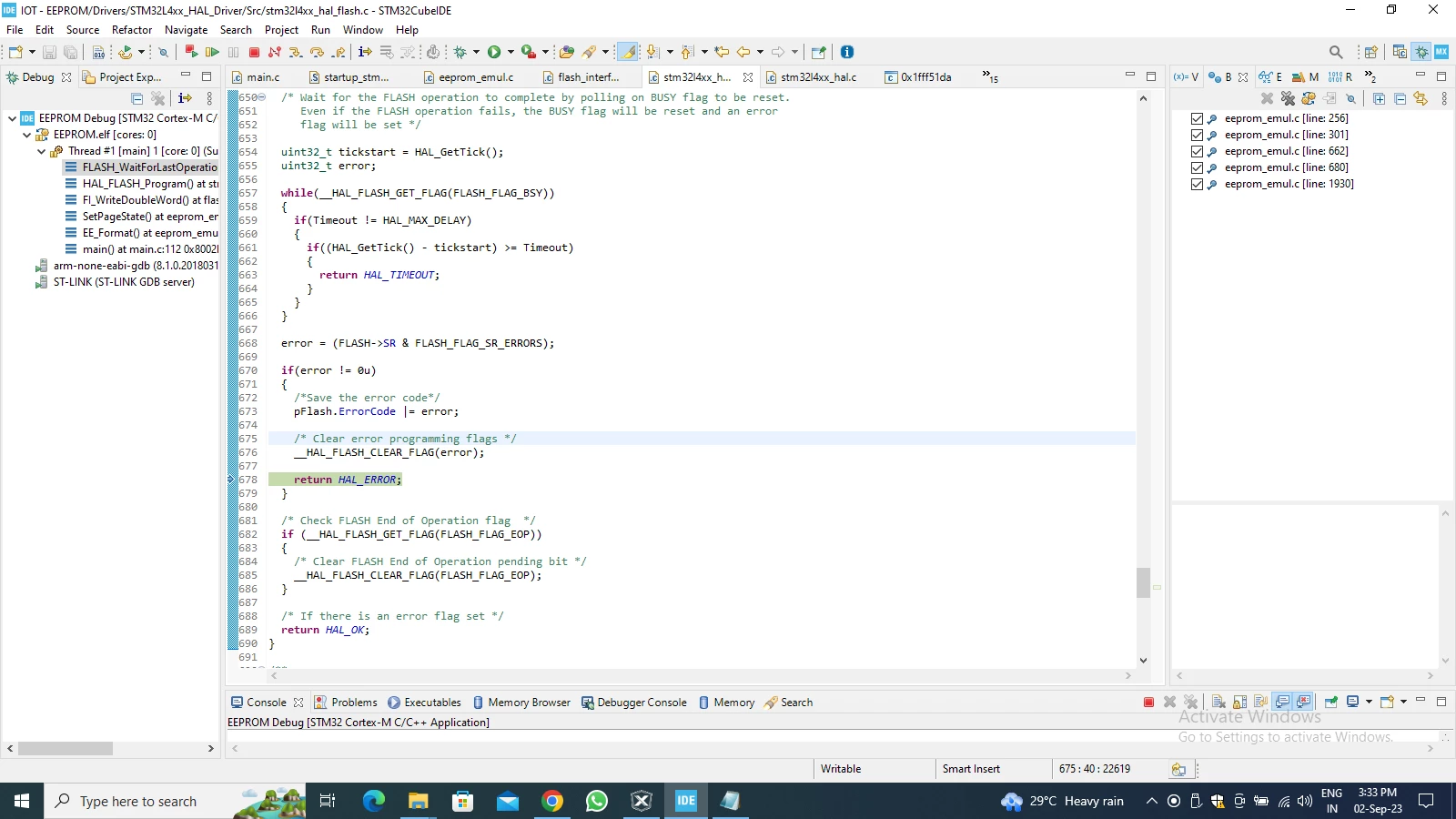

Hello STMicroelectronics community,

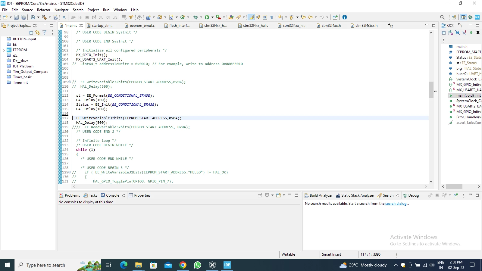

I am currently working on a project that involves using EEPROM memory with an STM32 microcontroller, specifically [STM32L4R5ZI-P]. microcontroller that does not have internal EEPROM, so I need to use the Flash memory for EEPROM emulation. I've installed the xCube EEPROM package, which provides driver layers and specifies the memory address to use.

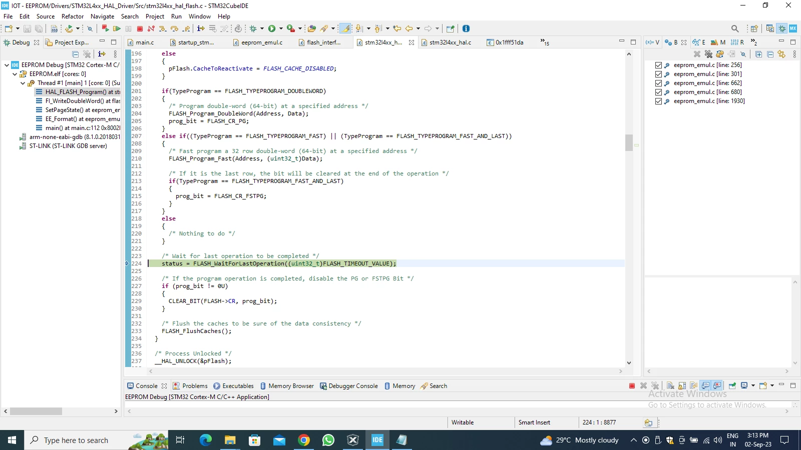

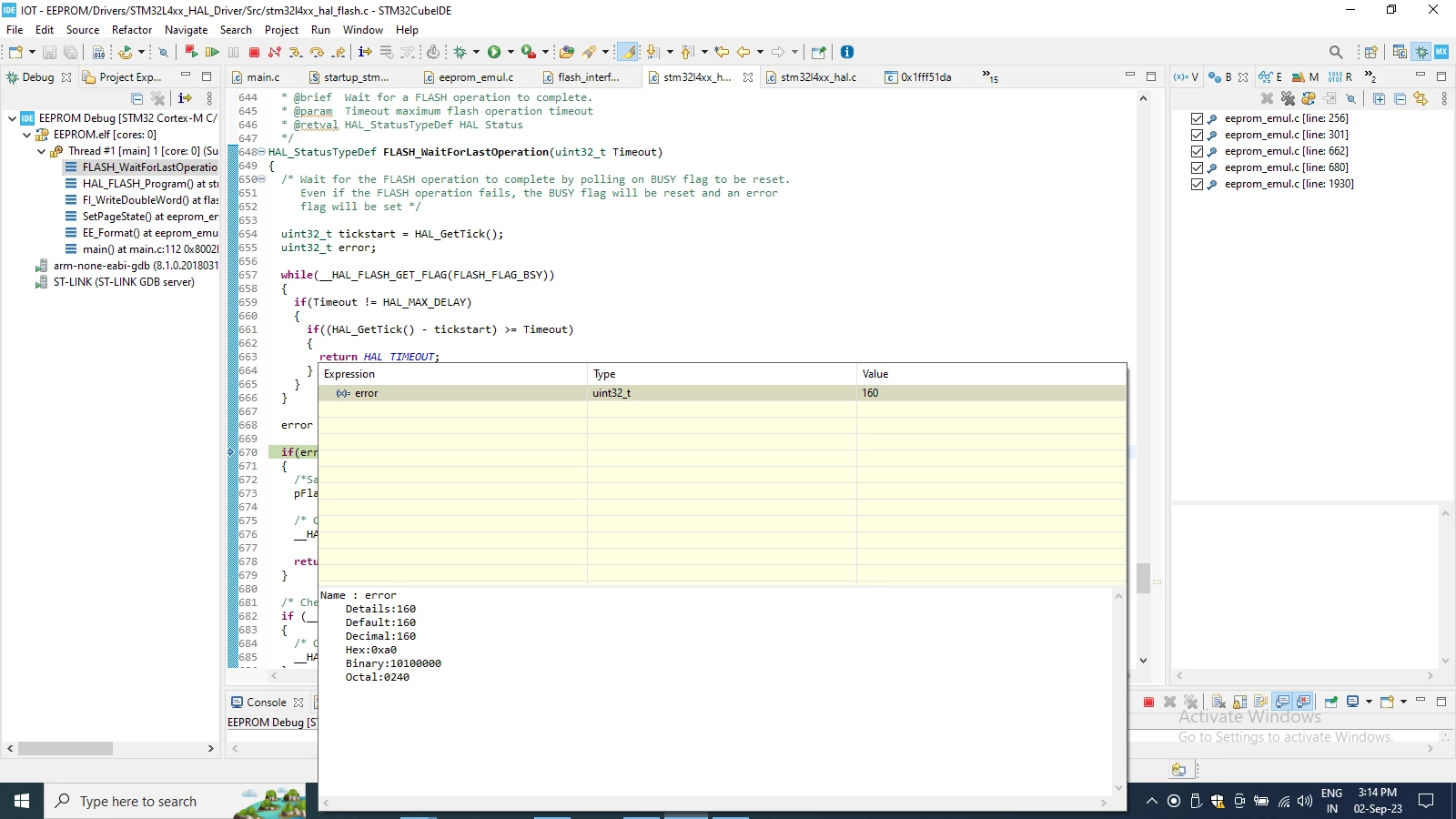

However, I'm currently facing an issue with not able write or read from Address[0x080FF000U] , while working with flash that is returning with an error = 160, i will be sharing the snippet for your reference.
with an error valuewith an error valueScreenshot (8).pngScreenshot (6).pngIntializationIntialization

HAL_StatusTypeDef FLASH_WaitForLastOperation(uint32_t Timeout)
/* Wait for the FLASH operation to complete by polling on BUSY flag to be reset.
Even if the FLASH operation fails, the BUSY flag will be reset and an error
flag will be set */
uint32_t tickstart = HAL_GetTick();
uint32_t error;
while(__HAL_FLASH_GET_FLAG(FLASH_FLAG_BSY))
if(Timeout != HAL_MAX_DELAY)
if((HAL_GetTick() - tickstart) >= Timeout)
return HAL_TIMEOUT;
error = (FLASH->SR & FLASH_FLAG_SR_ERRORS);
if(error != 0u)
/*Save the error code*/
pFlash.ErrorCode |= error;
/* Clear error programming flags */
__HAL_FLASH_CLEAR_FLAG(error);
return HAL_ERROR;
/* Check FLASH End of Operation flag */
if (__HAL_FLASH_GET_FLAG(FLASH_FLAG_EOP))
/* Clear FLASH End of Operation pending bit */
__HAL_FLASH_CLEAR_FLAG(FLASH_FLAG_EOP);
/* If there is an error flag set */
return HAL_OK;
here i have provided the function also, where i am facing an error.
could please help me to resolve this issue.
can you please provide any reference to work with microcontroller which we are working.
Thank you.

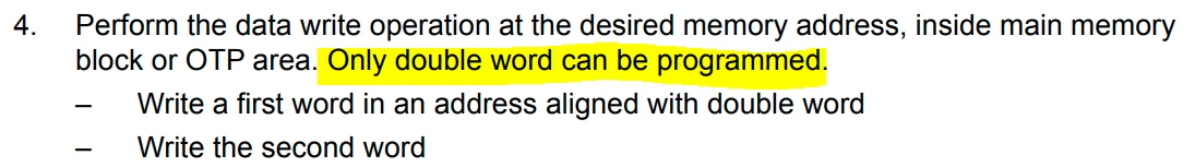

You must write 64 bits at a time at addresses that are 64-bit aligned.

hello ,
while try to write at that time ,i am facing that error.The code which i mentioned in my post has HAL_FLASH_Program[ Program double word or fast program of a row at a specified address]. in that facing an issue,
 /* Wait for last operation to be completed */
status = FLASH_WaitForLastOperation((uint32_t)FLASH_TIMEOUT_VALUE);
Thank you.

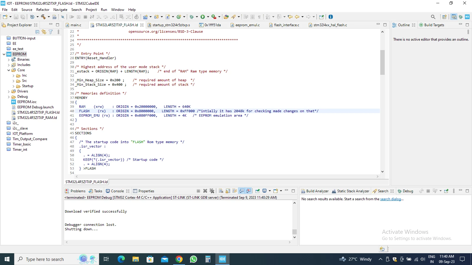

hello,
I have tried this shrink the FLASH but still facing same issue.
this way i have  made changes is this correct or need to change, help me to debug this issue.

Pavel A.
September 9, 2023
Documentation on this STM32 says that its flash page size can be 4 or 8 KB depending on some mode.
Are you in the right mode for 4KB page size as you assume?
September 11, 2023
hello,
Yes, I am using 4KB as a size.
Total Flash size is of 2MB,in that for EEPROM Emulation Using 4KB ,as mentioned in datasheet.
Do I need to go through with any other conditions to check?
Thank you.

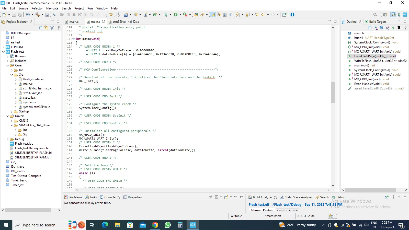

September 13, 2023

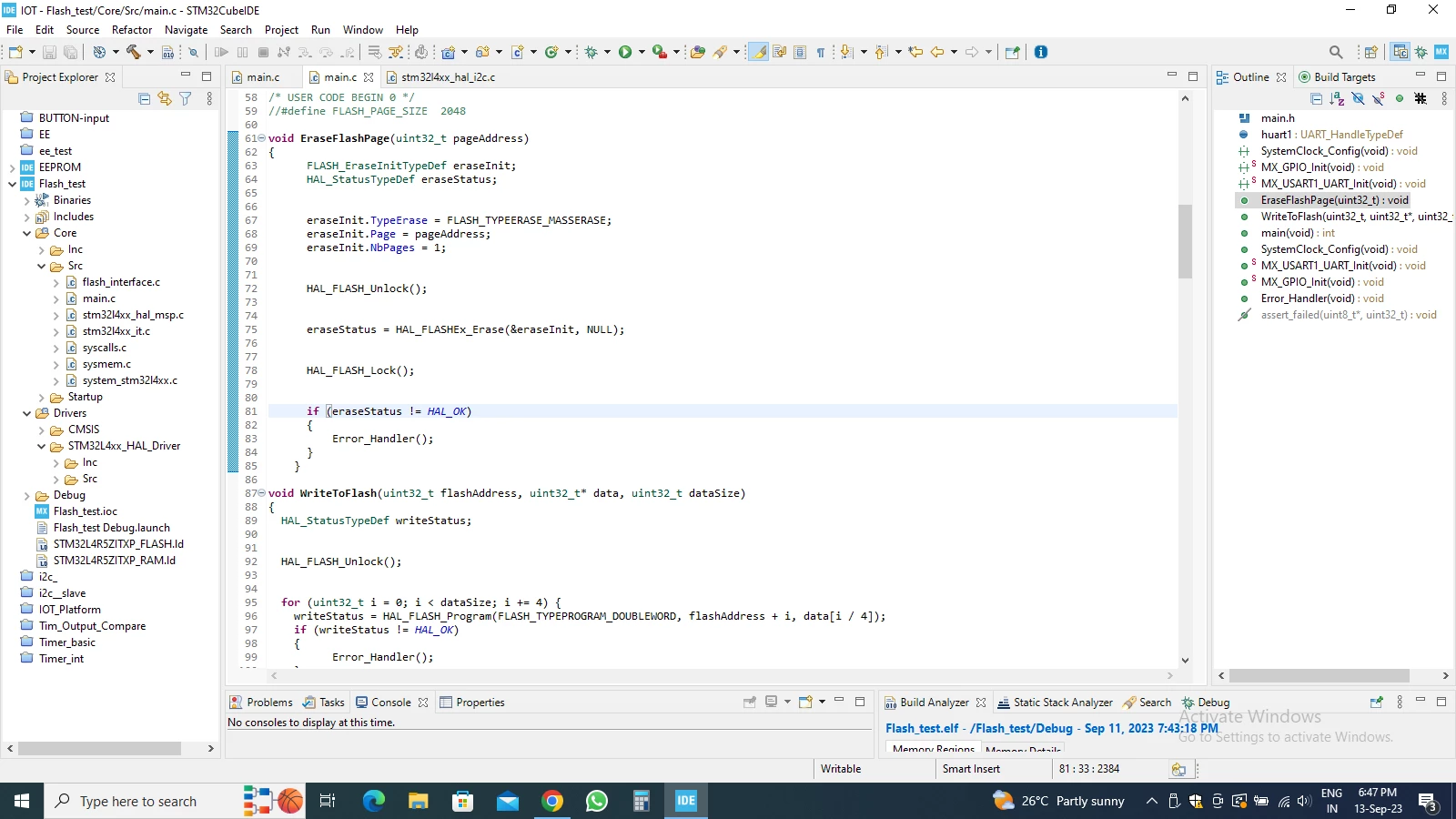

@yashaswini  Does this occur with a simple example (such as some ST Cube FLASH example for a similar board), not the "eeprom emulation"?
September 13, 2023
I have attached a snippet of that for reference, in this I'm trying write data to flash in that erasestatus it returns error.
September 13, 2023
September 26, 2023
I would recommend starting with an ST example that works and go from there. There are a number of basic errors with the code you've presented:
  • Page 1 almost certainly contains active code and erasing it will cause the program to malfunction.
  • Passing NULL as the error parameter is invalid.
  • pageAddress is no longer being used.
Here is one such example:
https://github.com/STMicroelectronics/STM32CubeL4/blob/4ca3922f320dbb2c4f3f9486f4a094f36125f31d/Projects/STM32L476G-EVAL/Examples/FLASH/FLASH_EraseProgram/readme.txt
September 27, 2023
