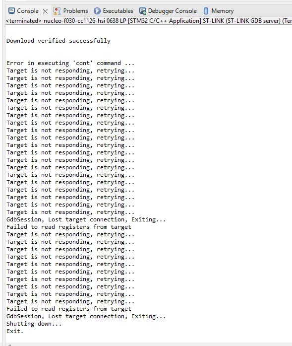

Need ability to cancel debug session on connection failure.
When the connection fails “unexpectedly”, CubeIDE keeps re-trying for a long time:
Although “unexpected” to the IDE, the reason may be obvious to the user - so it would be useful to be able to cancel these retries, exit the Debug Session, and return to the C/C++ perspective.

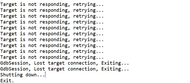

Hello ​@Andrew Neil
Let me thank you for your feedback.
I reproduced the behavior described in STM32CubeIDE, and when the connection fails “unexpectedly,” CubeIDE does not continue to retry for very long:
Thanks.
Mahmoud
Andrew Neil
Jul 14, 2026 1:59 PM UTC
Hmmm … I’m using CubeIDE v2.1.1 on Windows 11 Pro - you can see that it does take *much* longer than yours.
I think it always has done - certainly in v1.13.0
The above is with the ST-Link of a Nucleo-F030, when the SWD pins are set to analogue by the application.
So the target remains powered-up and physically connected, but SWD comms is lost.

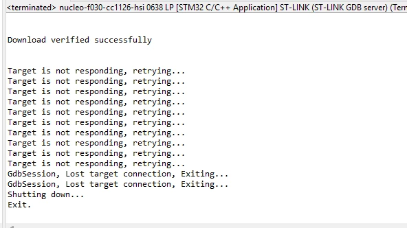

Andrew Neil
Jul 14, 2026 2:37 PM UTC
​@Mahmoud Ben Romdhane - If I do just remove the Target power, it does timeout a lot quicker:
That takes ~11s
