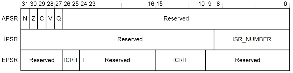

Name of CSR, where documented, where in Register View of STM32CubeIDE?
I'm seeking for the following information:
  1. What is the CPU flag/control& status register (CSR) called and
  2. where - ST document - is it documented?
  3. Looking at the STM32Cube IDE debugger view (gdb register view)
what is this register called and where are the Carry, Sign,Zero etc.
bits?

Download and read the "Programming Manual" for the MCU Family you use.
The ARM core registers are explained.

CPU registers will be part of the ARM Core - so will be documented in the ARM documentation; eg,
https://developer.arm.com/documentation/dui0552/a/the-cortex-m3-processor/programmers-model/core-registers?lang=en

Thanks. If you compare this with the register view of STM32CubeIDE,like:

How do they correspond? What are the bits for C,Z,S etc. in the PSR (xpsr)?
What do d0-d15 resp. s0-s31 stand for?
The d0-d15 and s0-s31are the floating point registers
Andrew Neil
May 17, 2022
Also get hold of a copy of Joseph Yiu's "Definitive Guide" book for whichever core(s) you're using...
