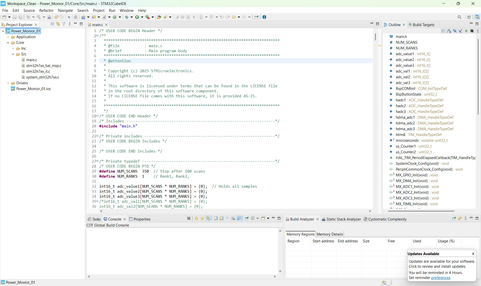

My project no longer show up in CubeIDE after upgrading it to 1.19
    My project was working fine under CubeIDE and CubeMX until trying to upgrade it to 1.19 version.
    My project disappeared even after tried to import it again (Got error).
     CubeIDE always stayed in HOME page.
    I had to uninstall 1.19 and reinstall 1.18.by doing below Action
1 Uninstall STM32CubeIDE from Control Panel
2 Delete C:\Users\rongw\.stm32cubeide\ :white_heavy_check_mark:
3 Delete C:\ST\STM32CubeIDE_<version>\
4 Reboot (optional but recommended)
5 Reinstall STM32CubeIDE 1,18.
6 Choose a clean new workspace on first launch
7 Re-import your .ioc project folder (I did autogenerate code from CubeMX before importing)
  Then  IDE stayed in HOME Page,
    Please help,
   Thank you very much!

When tried to import again, I got error " Some projects cannot be imported because they already exist in the workspace"
CubeIDE always stays in HOME Page.

What is the home page? Go to the project explorer from Window -> Show View -> Project Explorer. Show a screenshot to illustrate what is happening.
Jul 11, 2025 11:05 PM UTC
"What is the home page?" - It is CubeIDE start up window. it does not go to project window.
"> Show View -> Project Explorer" - nothing shows up.
Thanks

So the Project Explorer tab doesn't show?

Clearly, you're missing a close icon or something to get back to the normal view. I wonder if there's a way for you to show us what you're seeing on your screen. I bet someone could point it out that way.
Jul 12, 2025 1:36 AM UTC
CubeMX Auto Code generation created STM32CubeIDE directory inside the project directory. I had to deleted it.
I got the project displayed normally. But it does not build project when clicking "Project -> Build Project"- Nothing happened.

I see that the Project has an "!" on the icon and on the IOC file. How did you import the project? Did you use Existing Project into Workspace?
