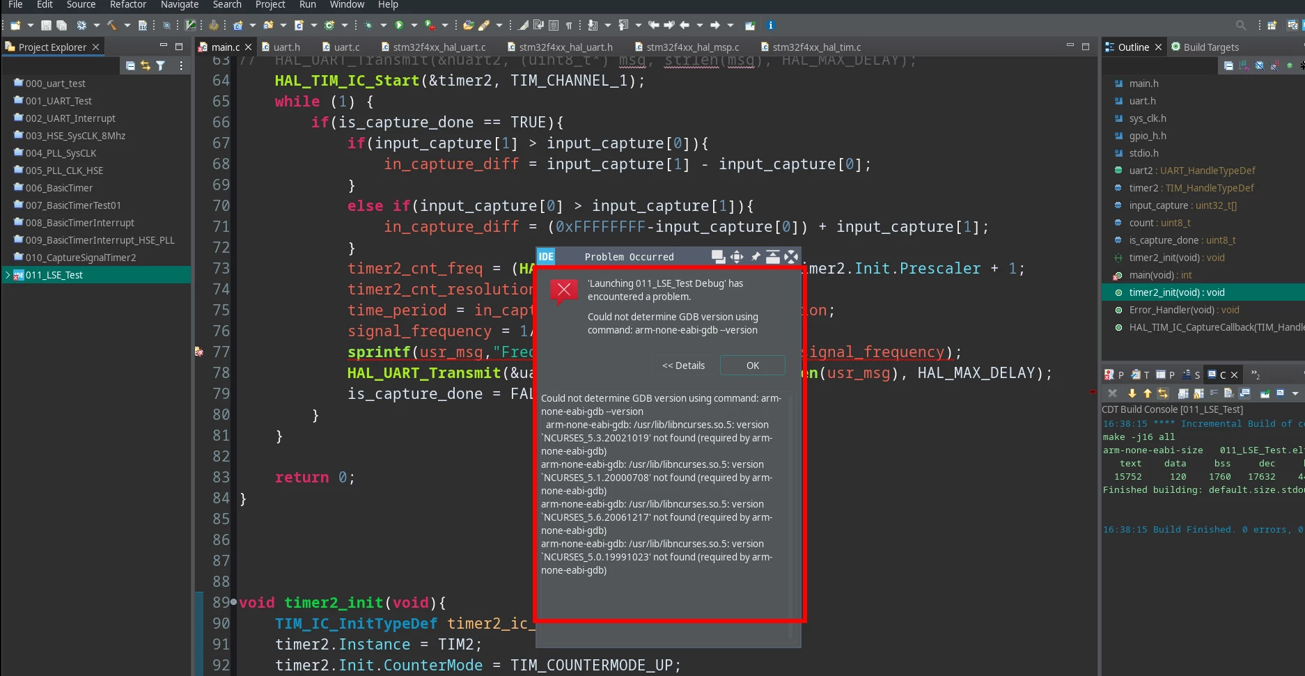

My project is building successfull but cannot upload it to STM32Discovery board and the stm32cube ide is showing libncurses related error on Manjaro Linux.
Below error is throwing in Manjaro Linux when I try to upload the program to the board. The project is building successful. Installed libncurses from AUR as well as the offiicial repository, but no use.

MM..1
July 9, 2022
You need concrete NCURSES version , latest libncurses isnt full backwards compat. Your error window show required version.
Pavel A.
July 9, 2022
Why gdb wants libncurses at all? it does not display any text based UI in this environment.
George_Costanza
George_CostanzaAuthorBest answer
July 14, 2022
Solved the issue. You need to install arm-none-eabi-gcc & gdb then set the toolchain as local from Windows->preference->stm32 toolchain. See the video below,
