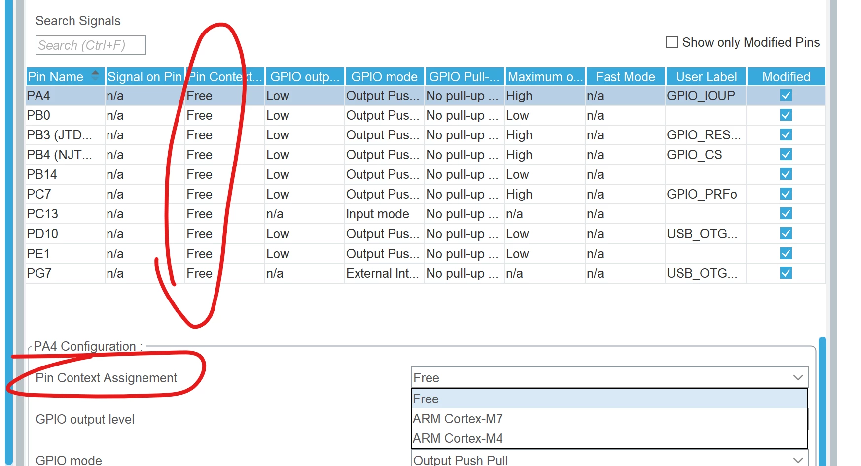

My cube ide is not auto generating code for modified GPIO's of H755ZI-Q ioc file.
hello,
I have started a project where I have to use SPI, USART, and some modified labeled GPIOs in the nucleo-H755ZI-Q (nucleo-144). Whenever I configure the GPIOs in my ioc file and click generate code. My Cube IDE is not auto-generating code for my modified GPIOs. i have checked again and again there is no option for selecting the core for GPIO_output. Has anyone ever encountered such a problem? For reference, I will attach my project file.
1. I have used Cube MX for generating the IOC file and then imported it into Cube IDE. It did not work.
2. I have repair reinstalled my Cube IDE. No use, did not work.
3. I have downloaded and installed the upgraded version 1.18.1. still facing the problem.
4. I have downloaded and installed the 1.16.0 version. still facing the same problem.
TDKBest answer
Jun 30, 2025 2:02 PM UTC
Go to the GPIO tab on the left in an recent version of CubeMX.  v6.14.1 works.

Jun 23, 2025 3:45 PM UTC
None of your GPIO pins have been assigned a core context. Assign them here and they will be initialized in the corresponding core's code.
Jun 30, 2025 9:56 AM UTC
Can i ask which software or cube ide version you are using? Can you navigate me from where will I get this options ?
Jun 30, 2025 10:17 AM UTC
Hello @Faizan_001 ,
Further to your comment, you can use STM32CubeMX 1.14.1.
Just click on GPIO under System Core and you can access to the GPIO Parameter Settings.
Thanks.
