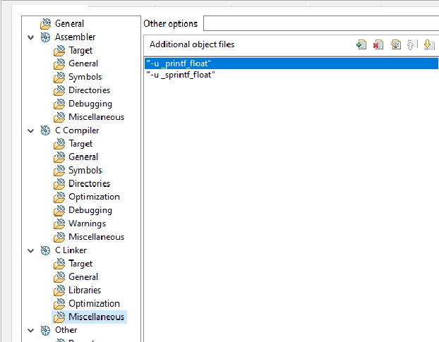

My ADC working but not able to sent float value on UART. Only integer its working fine. But when I sent float value using sprintf function then it sent only zeros.
My code is below,

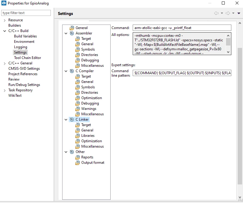

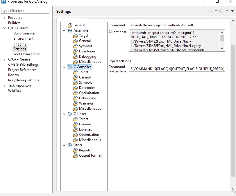

I have set the linker  -u _printf_float in command and -mfloat-abi=soft in Compiler
but not got success yet. please

I am using Atollic true studio,
STAR
STARAuthor
October 1, 2020
  not able to find -mfloat-abi=soft  settings in atollic true studio

October 1, 2020
required settings in atollic true studio.
