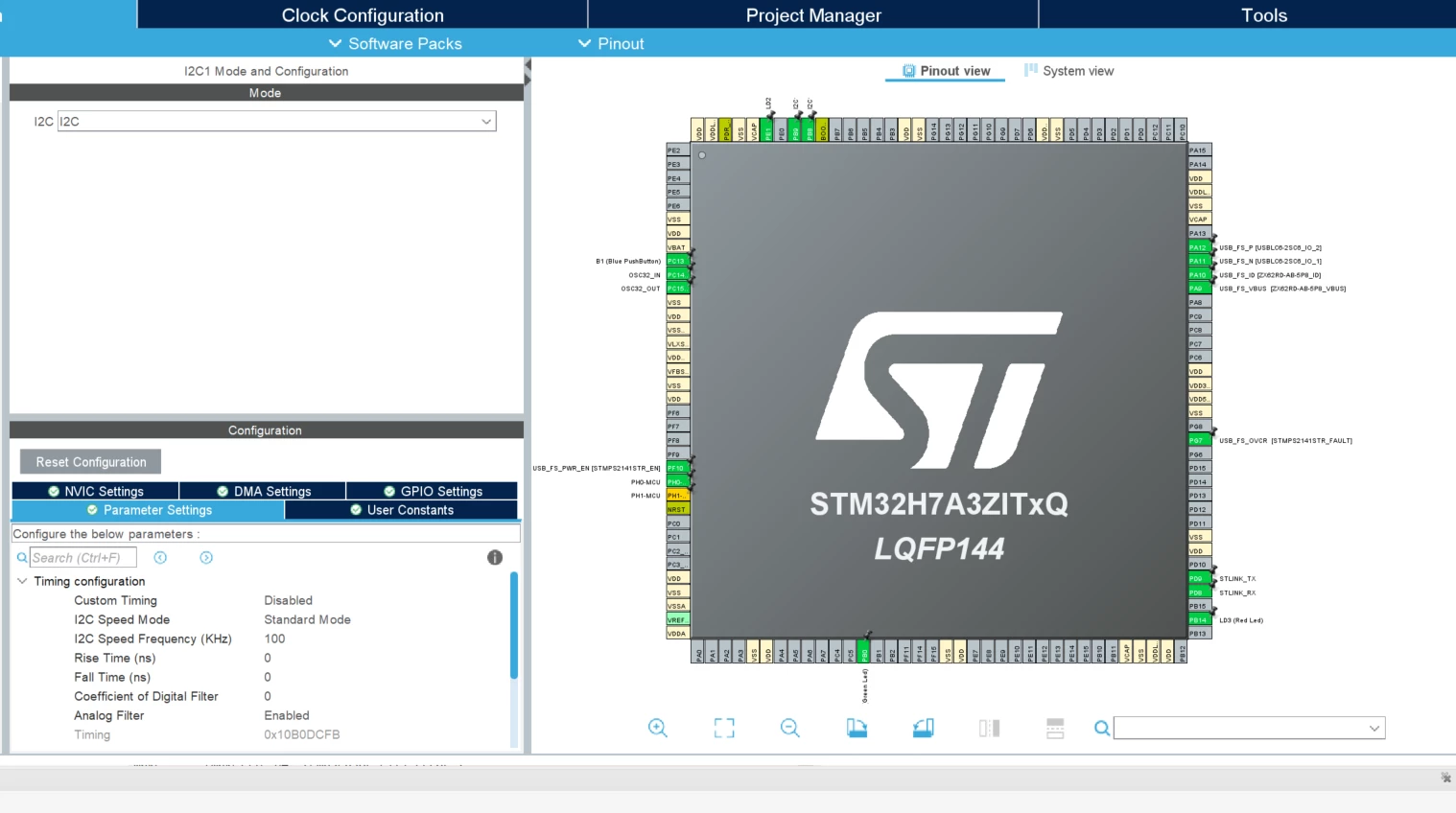

MX_GPIO_Init' used but never defined
Here is my code and I encountered the error. I use H7A3ZI-Q board

Is MX_GPIO_Init defined? The error suggests it isn't. If it is, attach your IOC file. Attaching the full main.c file would be helpful too. Could be a bracket mismatch issue.

zniuAuthor
October 2, 2023
October 2, 2023
Okay, so it's not defined in main.c, but neither are your other MX_*_Init calls. Is it defined in gpio.c?
Your stm1.PNG file doesn't load, and you didn't attach the IOC which would be needed to investigate further.
October 2, 2023
ST's forum software often doesn't let people attach IOCs for some reason. Feel free to leave negative feedback in the Feedback Forum.
Can't really offer much other help without that, other than suggesting updating to the latest version of things, if you're not already there.
