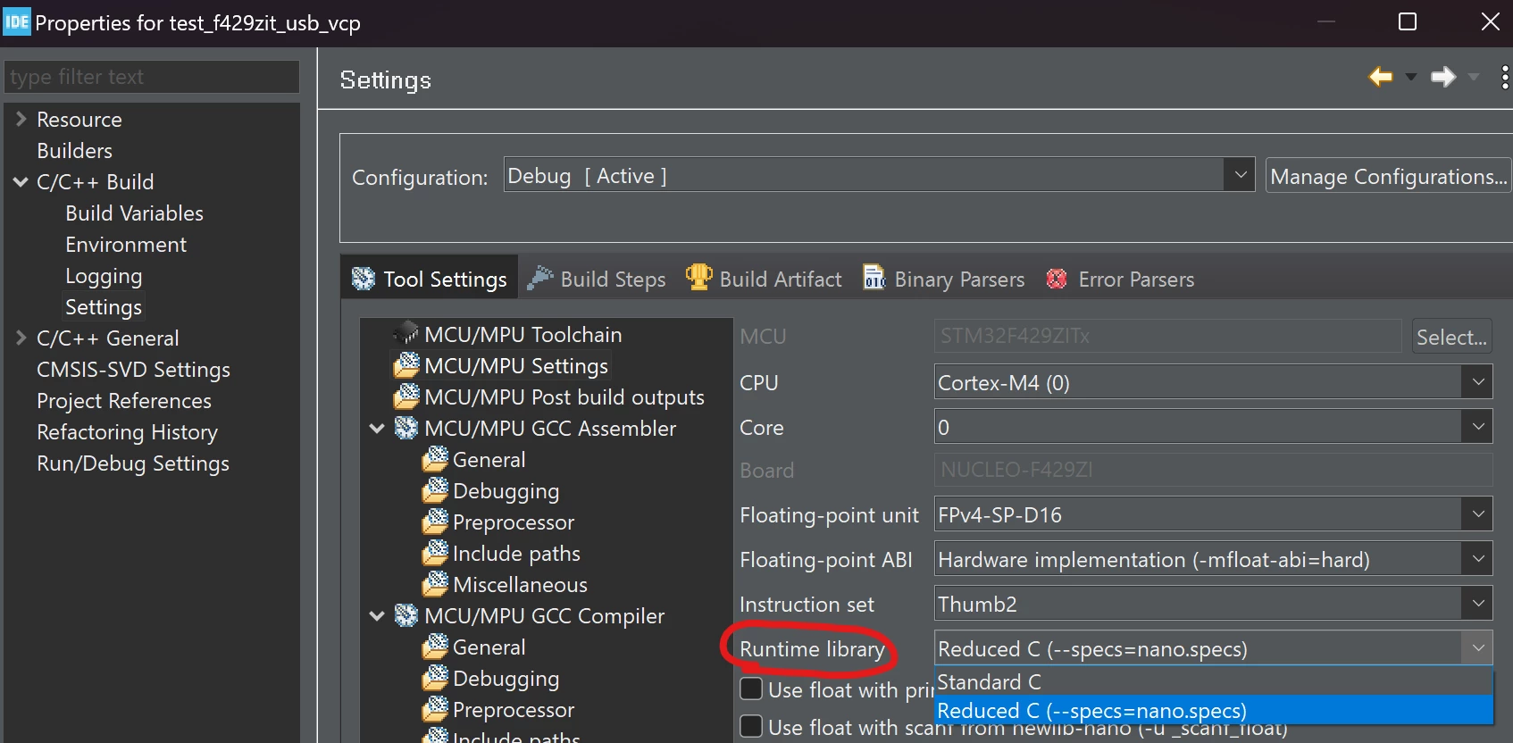

Hi all,
Very new to STM32, day 2 now, managed to get some UART output and call into C++.
However when I try to use standard C++11 threads I get this error "'mutex' in namespace 'std' does not name a type". I believe this is bc arm-none-eabi-g++ is configured with --disable-threads (checked with "arm-none-eabi_g++ -v").
Any way to get (standard) threading support? Should I try to rebuild the toolchain with --enable-threads?

Did you #include <mutex>?
Might not be in the reduced C++ implementation. You can change to the standard implementation in project properties.
Embedded C++ often implement only a subset of the full spec due to limited resources.

Dec 13, 2024 9:08 PM UTC
The setting is in project properties. This is for C. If you have C++ enabled, there will be a page for C++ as well.
Might want to be more specific about your case. "STM32" encompasses thousands of chips in wildly differing capabilities. In particular settings for MPUs vs MCUs will be quite different.

Dec 14, 2024 10:38 AM UTC
Thanks TDK, but unfortunately switching it to standard c++ didn't make a difference. Still no std::thread and friends.
I'm using a NUCLEO-U575ZI-Q board with STM32U575ZIT6Q MCU. Willing to switch to another MCU if it supports standard threading, but I think this is an issue for the entire STM32 family.
