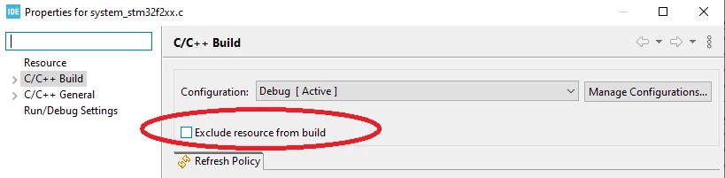

    For some reason this has sometimes happen to me also with earlier CubeMx versions when update project. You can select \Drivers\CMSIS\Device\ST\STM32H7xx\Source\Templates\system_stm32h7xx.c file properties and from C/C++ Build page select 'exclude resource from build'.
