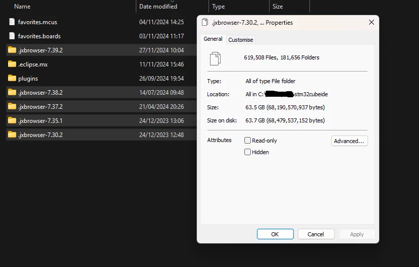

Hi all.  I have been witnessing a rapidly shrinking amount of free space on my C drive.  On a regular drive clean up of non-essential data, I can generally remove 1 Gigabyte or so of temporary files.  This however, does not account for the rapid depletion of available free space.
On further investigation, I looked into the 'Other' (Manage other large folders) section of the 'System -> Storage' properties of my Windows 11 C drive.  I was a little gob-smacked to discover that - between them - the ST related folders: stm32cubeide, stm32cubemx, STM32Cube and ST contain over 100Gb of data.
Obviously allowing for software packs and the various STM applications in daily use, I found a considerable amount of data was held in several .jxbrowser folders across more than one location.  For example, the .jxbrowser-7.38.2 folder inside the stm32cubemx directory - alone - is at a whopping 17.5Gb.  I don't see any way of cleaning them or whether or not it is safe to do so but I read elsewhere (on other sites) that they should be left alone.  The screen grab below indicates the total size of the multiple .jxbrowser folders in stm32cubeide:
Screenshot 2024-11-28 100508.png Does anyone else have any experience with this?  Better still, if there is a solution I would love to know what it is, hopefully before my drive gets chockers-full.   Thanks in advance.

@Egolt.1 It is possible to keep the issue under control to some degree.  I manage it by deleting the folders with the oldest content first but stop way before the most recent (just to be safe).  I haven't noticed any negative impact on my system by doing this but I can't say with any certainty whether or not it's good practice.  If I recall correctly, last time did this, I removed some 720,000 separate files.  I just knew I had to free up some space somehow.  Hope this helps.

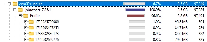

I'm having this issue as well.  97k files and 9.5GB.  is there any more info it?  i dont see how raising a ticket with no further info constitutes an "accepted solution" to be honest!

In my case, it is roughly 50 GB taken by jx-browser 7.30.2 and 7.35.1 (roughly 300k files).

I looked more in details in my "jxbrowser" folders.
First of all, it is related to CubeIDE, not (standalone) CubeMX, as it sits in \username\.stm32cubeide\
Then there is a version number append to the jxbrower, in my case .jxbrowser-7.30.2 and .jxbrowser-7.35.1
I believe this version number is bumped when you update CubeIDE (but that is to be confirmed).
As @michaelmac I never ever close CubeIDE through the task manager, I always perform a clean exit.
So what you claim @Mahmoud Ben Romdhane is not true regarding the autodelete fo the folders.
If you look into each jxbrowser folder, you will find a working copy of Chromium. Do we really need to have a copy for each jxbrowser folder ? Can't it be rationalized in 1 level above ?
And in the profile folder itself, I can see that each subfolder is created everytime I launch CubeIDE, and its name is the UNIX timestamp of the launching. In .jxbrowser-7.35.1 on my computer I have 700 folders like this, since I use the tool at least once per day.
