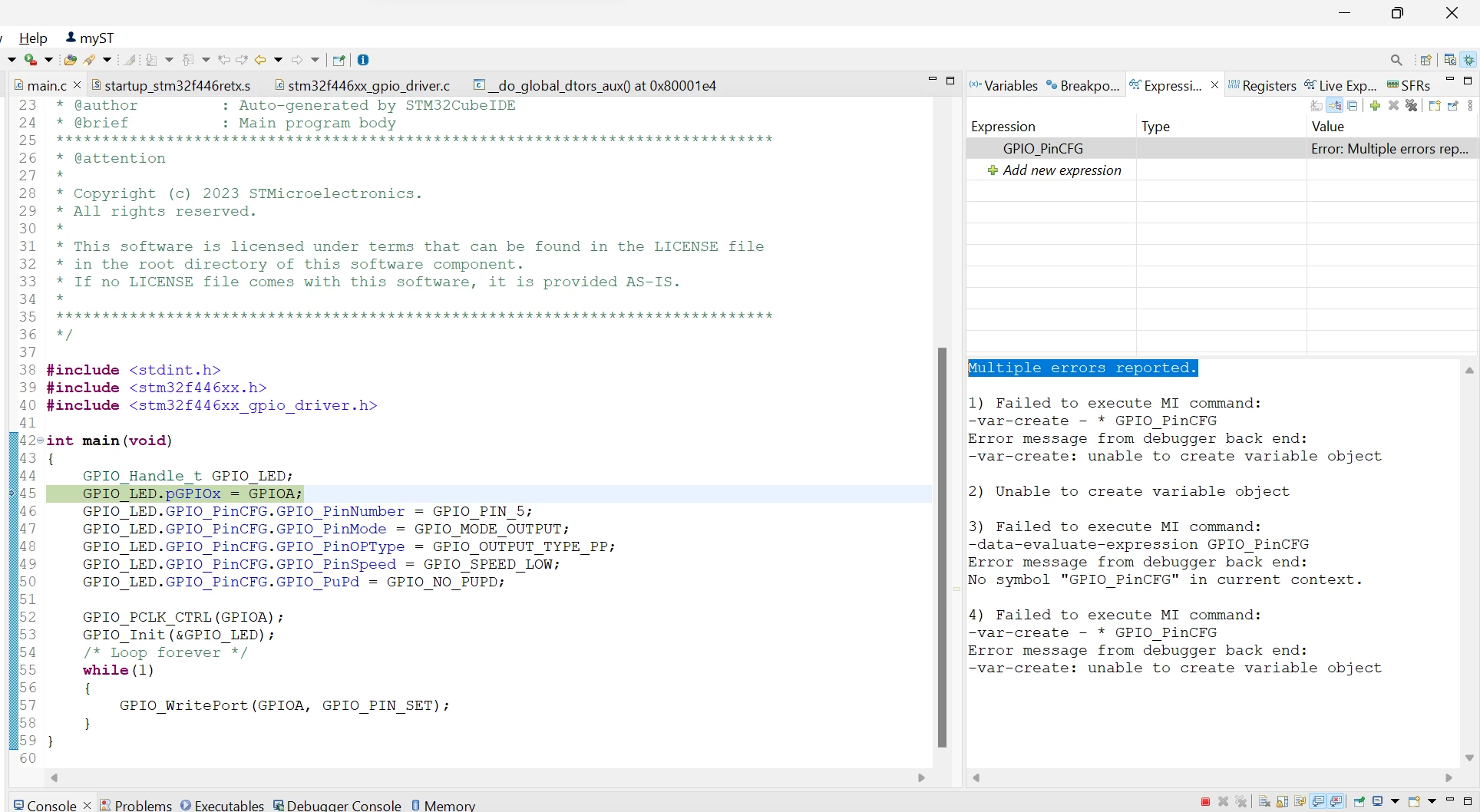

Hi, currently I have an issue during debug. I'm writing a bare metal code to blink a LED, when I compile the code there aren't any error occur. But when check the Expression I got this errors, I have search everywhere but I can't find the solution yet. Can somebody point out what I did wrong and what I should do to overcome this Issue please.

    How can the Expressions window display something that is probably not there?
    Where did you define the variable GPIO_PinCFG?

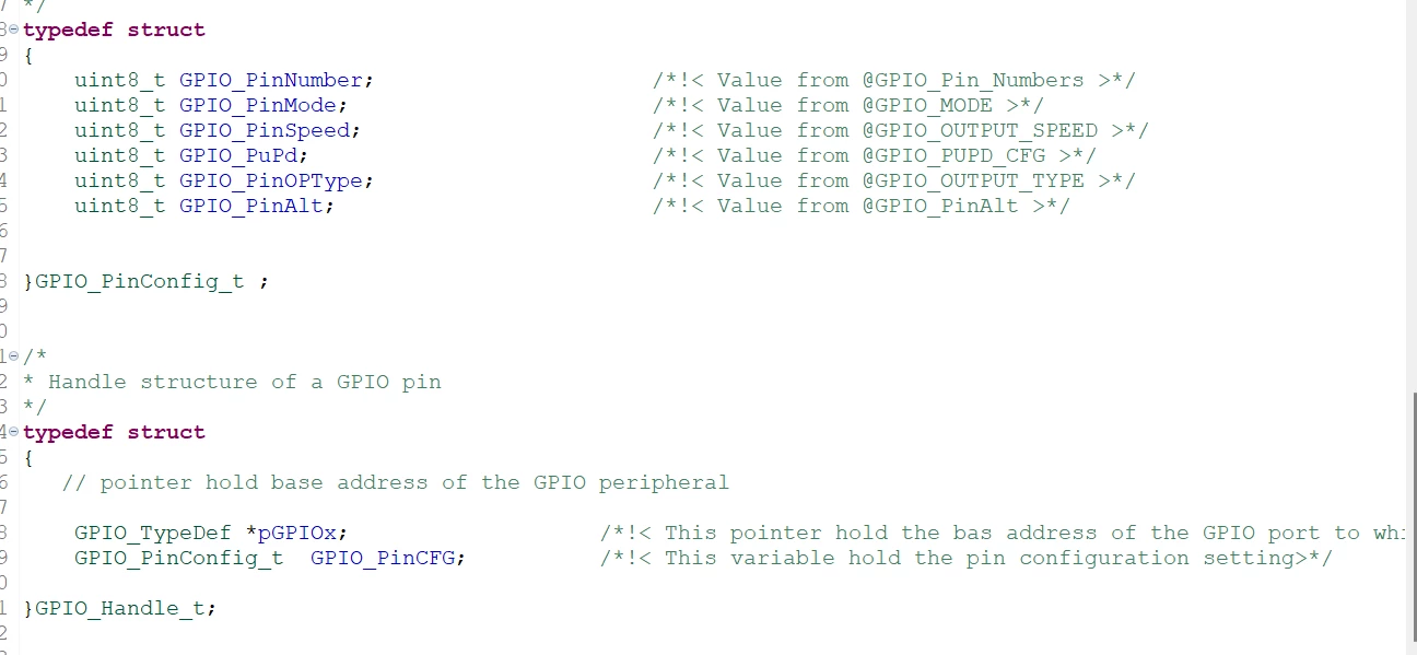

    I define It as a struct in another header file which I've already included

    Read the error.
    No symbol "GPIO_PinCFG" in current context.
    Can't show the value of something that doesn't exist.

    And that is a weird thing because I had created a struct for it in the header file which I've already included

    Anyway - as the name suggests, a struct only specifies the structure that is then instantiated. Instead of just one member of such a struct, however, you have to specify the instance - how is the GUI supposed to know which of the (possibly) many instances you are referring to?
