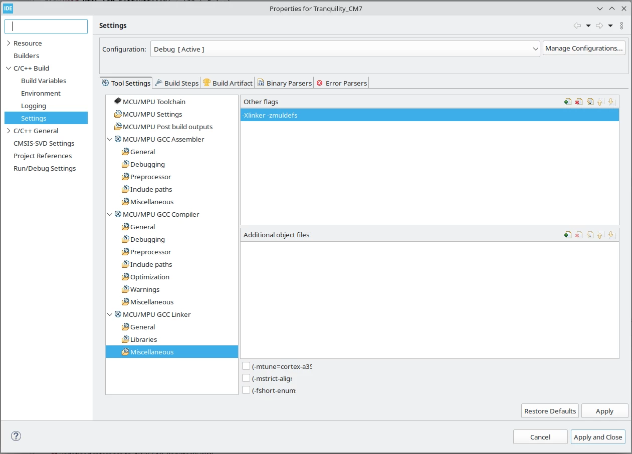

the toolchain changed to gcc 10 and therefore tentative definitions in header files are no longer ignored.
You should not define variables in headers, but rather use extern in header files and define it in one source file. This has always been a error, but was ignored in gcc 9. So to fix this either use -fcommon
to compile or the better solution is to declare the variables in the header as "extern" and define them in one source file. Heres the link to the GNU GCC 10 source:

Apparently this is some new bug. had it just after updating the project to the new version.
Solution that worked for me: open project properties -> settings, under MCU GCC Compiler select Miscellaneous. Click add flag -fcommon
