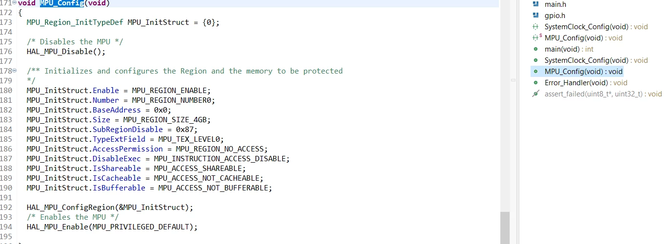

MPU_Config(void) instead of MX_GPIO_init(void)
I am working on STM32H743VIT6 MCU. when I generate the code, I get MPU_Config(void) function instead of MX_GPIO_init(void) with no GPIO configuration. How can I fix this?

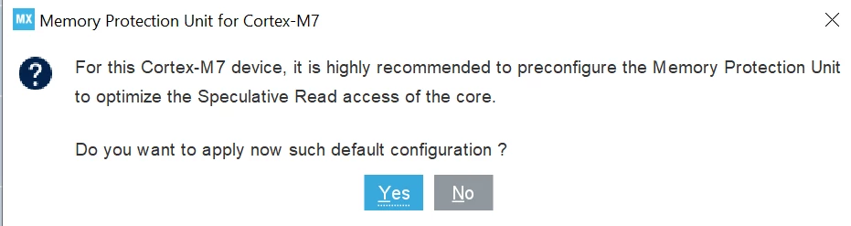

    For this cortex-M7 device, it is recommended to preconfigure the MPU. So, on the last versions of CubeMX when you select this MCU and a few other cortex-M7 MCUs and Click on start project you will receive this message:
    Clicking Yes will generate a configuration of the MPU on the function MPU_Config(void). If you don't want, you just have to answer No to this message.
    Best Regards.

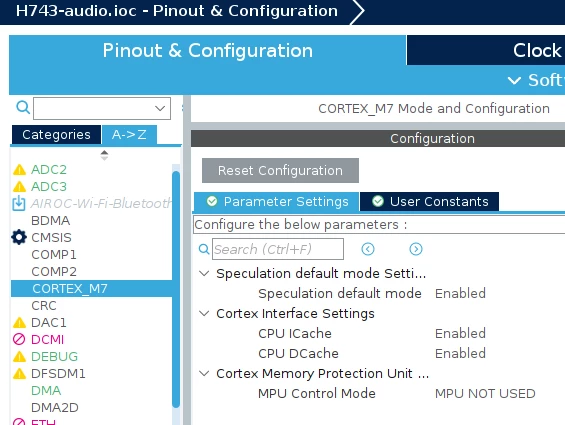

    Here is the .ioc file. now I get the MX_GPIO_init(void) function but i still have MPU_Config(void)
    AScha.3
    (i also use the devEbox H743 board)
    so just dont use the MPU , if you dont know how to use :
    Afsd24Author
    Thank you for your help. it works properly now
