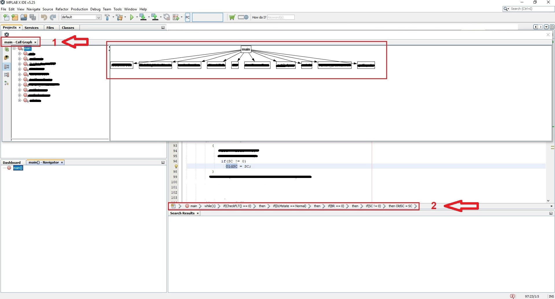

In MPLAB IDE there are two features that I find very helpful. (please see the attached file)
Feature 1: Call Graph
Feature 2: The code flow of where the cursor is
Are any of these features available in CubeIDE?
(Sorry I had to blacken things out, this is not my code)

I guess Eclipse market place is your best friend here.
Just googling I'm getting: https://marketplace.eclipse.org/content/callgraph-viewer or https://www.eclipse.org/linuxtools/projectPages/callgraph/
Not sure this one is ok but plenty of others ...

  1. Thank You!
  2. Regarding "feature 2" any idea on what should I look for?
