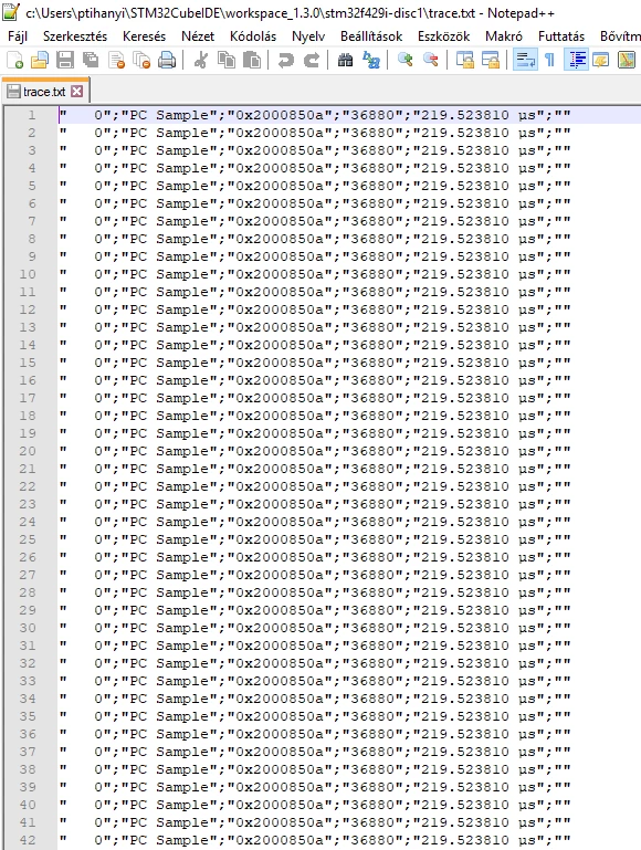

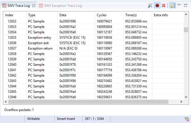

When I want to copy data records from any of the SWV views/windows, an interesting bug (or feature?) appears:
  • When I select less than 1000 lines (or records), I can copy/paste selected data to any text editor
  • When selected data contains more than 1000 records, CTRL+C activates a "Save AS" dialog, and it saves a CSV file contains repeating lines
I already reported the Exception Timeline Graph bug three months ago: this function is useless. Not only I didn't get an answer, no one responded to this problem.
