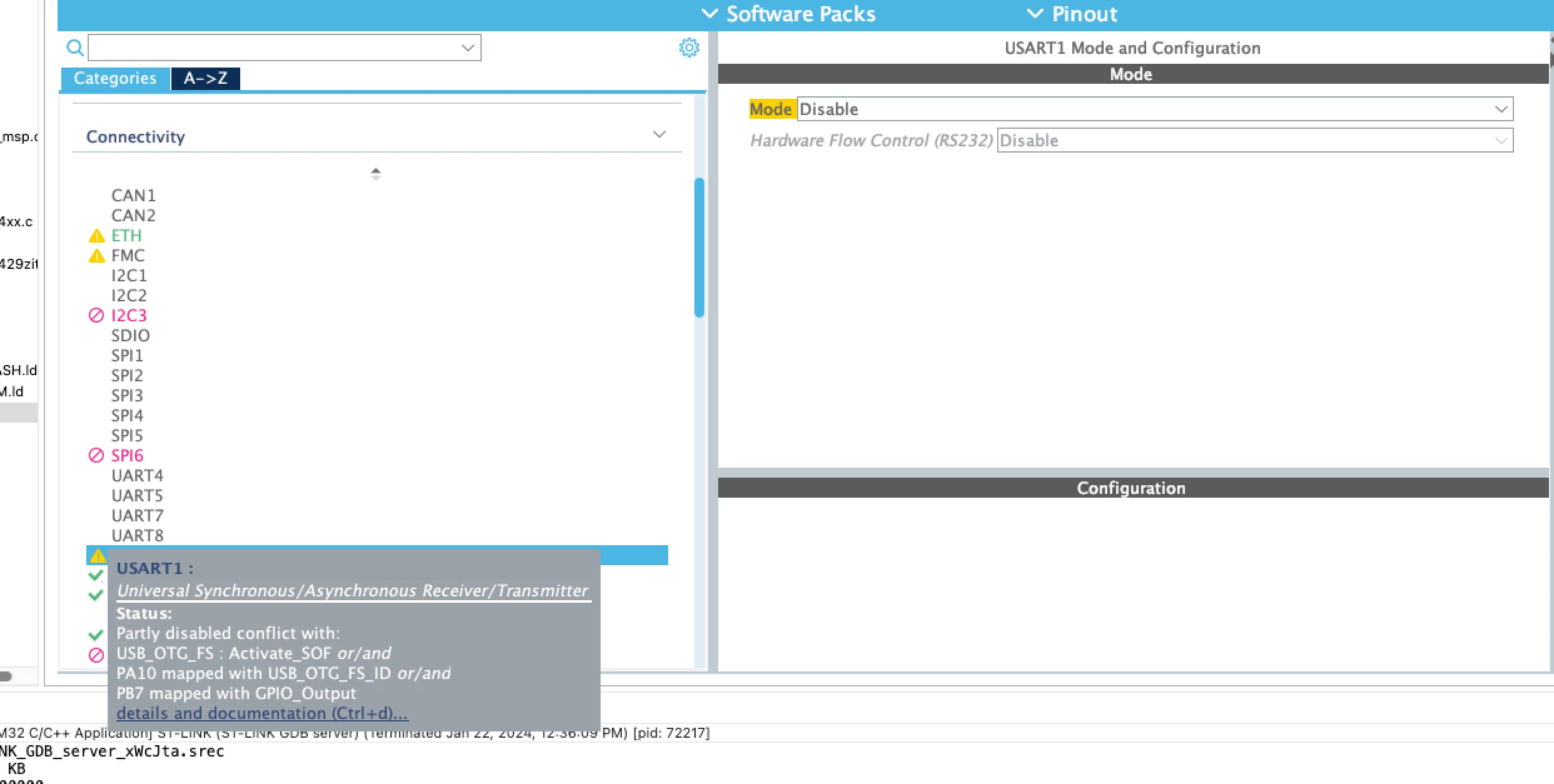

I am running CubeIDE on OSX (not sure if t hat makes a difference)
In the pinout & configuration you can see that some of the configured items, for example ETH and USART1 have a little green triangle next to them, indicating what I believe is a conflict.
If I hover the mouse over the icon, in just the right place, it will show a popup, but, no matter what I do, after a second of being visible, the popup disappears again, so I do not get long enough to read what its telling me, thus cannot figure out what I am being told.
Is CubeMX really this buggy/ Is there some other view I can look at that will give me information about these conflicts so I may try to resolve them?

    Probably the best approach is to temper your expectations. CubeMX is written in Java, meant ostensibly for Windows, and cobbled together to support OSX and Linux. Even in Windows, where 90+% of its users exist, it has flaws and general performance issues. The OSX and Linux support are just never going to work as well. If the worst issue you have is that tooltips disappear after 1s, consider yourself lucky.
    In Windows, if something disappears before I can see it, performing a using print-screen and bringing up the screenshow in ms-paint will let me read what it says. I'm sure OSX has something similar.

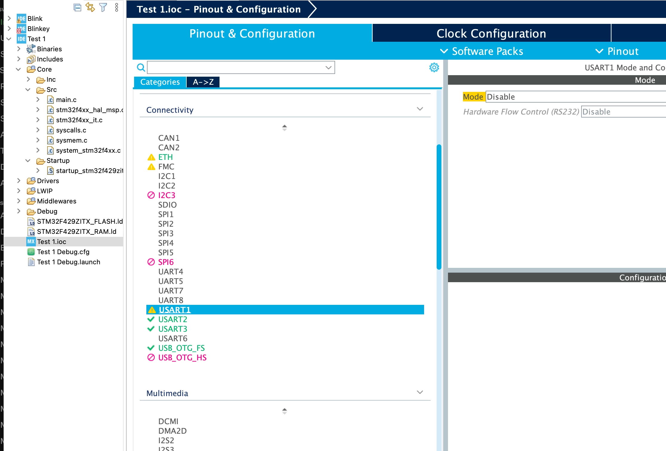

    If you talk about the yellow triangle ... :)
    - this is only a warning, not all modes or pins available, because you already used some of them.
    You anyway see details, when you click on the yellow marked thing, here your usart1 :
    (mode , also yellow) will show you, whats available, or not (red). Thats all.

    Unfortunately, clicking the icon does not show any addtional information, I guess thats an OSX thing.  I did manage to grab a screen shot as @TDK suggested, so can see the error now. I cannot of course click on the documentation link to get more help.  Unfortunately as a noob to these STM32 devices I really can only guess at what this even means,

    Misunderstanding - not ON the icon, just ie in usart1 "mode" click in the selection box "disable" , then you see , whats (still) possible or not.
    CubeMX is a separate program, to edit the pinout + generate code then.
    In IDE its just integrated, for a better "all in one" feeling. (Just the bugs...destroy the feeling ...)
