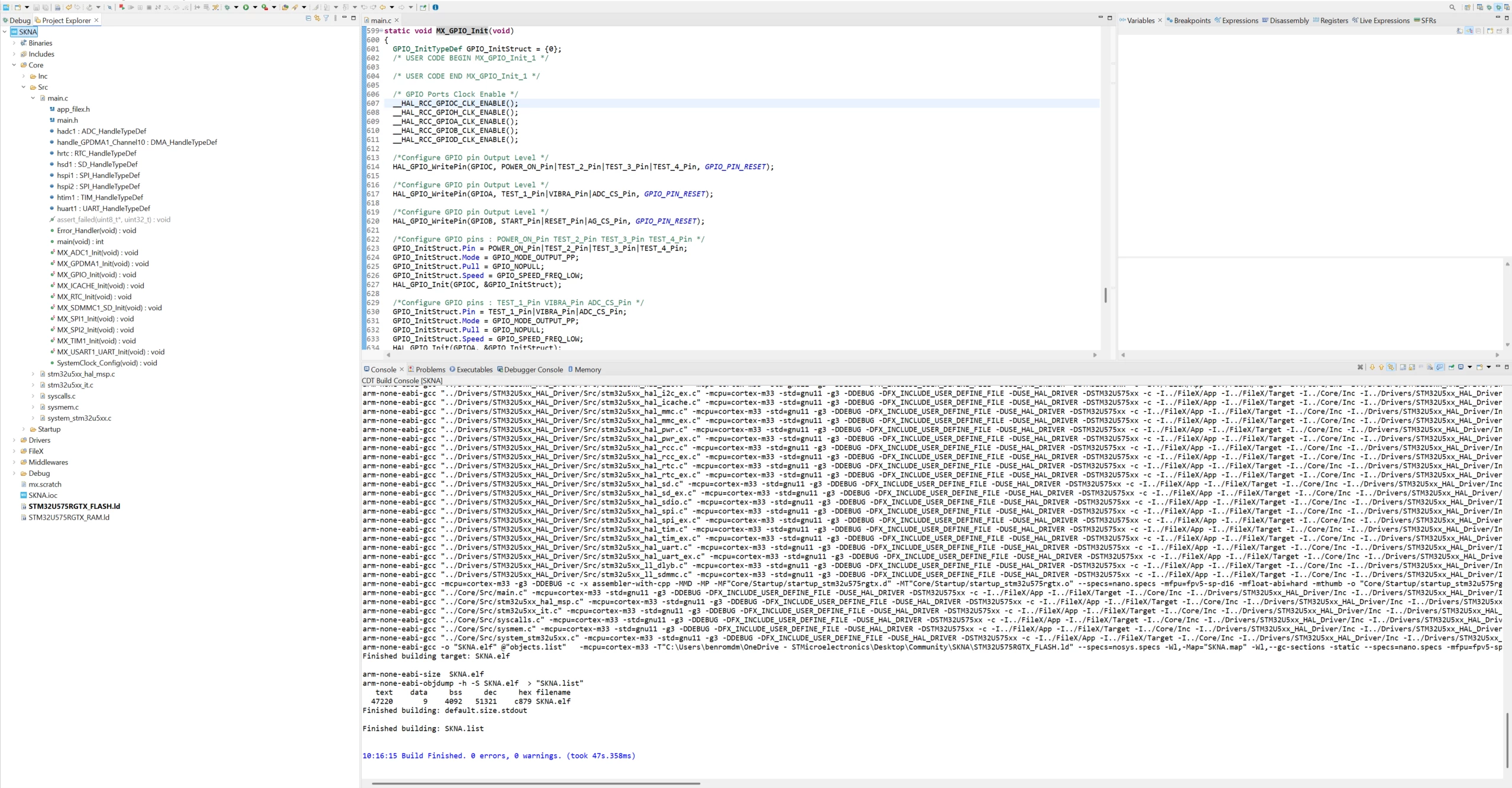

I have project for STM32U575 created in CubeIDE just before new release of separate CubeIDE and CubeMX.
I imported it into the new version of CubeIDE (2.1.1, it asked whether to “renew” project, and I clicked "yes").

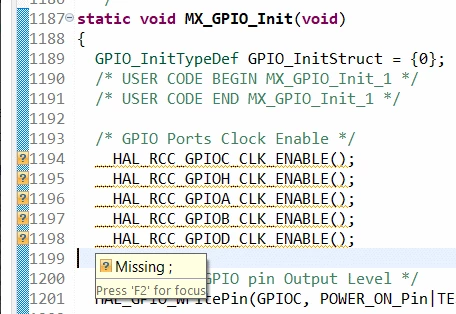

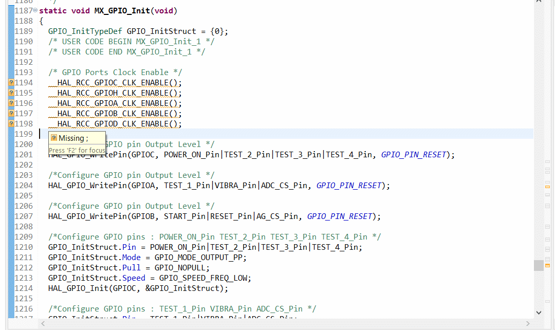

Both then and now, the project has this warnings:
I didn't pay attention to it earlier because the project was working, but now I see that there are more and more strange problems in it. Could it be because of that?
What could cause such warnings? This part of code is not mine, but generated by CubeMX.
I didn’t have this warnings on another project for STM32H7.

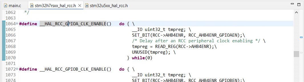

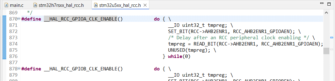

HAL code looks very similar for H7 and U5:
H7:
U5:
But only the one for U5 generating warnings.

Andrew Neil
Jun 18, 2026 10:49 AM UTC
​@Amida
The screenshot shows a warning on all 5 of those lines - are they all the same warning ?
Are there any other warnings/errors ?
Are they actual compiler warnings, or just from the IDE editor?
It says, “Press ‘F2’ for focus” - what does it show when you do that?
Have you tried looking at the Preprocessor output - to see what the compiler’s actually seeing?

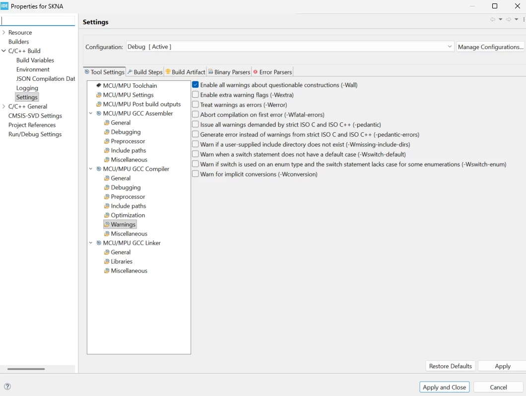

AmidaAuthor
Jun 18, 2026 10:54 AM UTC
​@Mahmoud Ben Romdhane: It was probably related to the Index. I couldn't find the button to manually rebuild the index. But when I opened the window with the warnings settings (the one from your screenshot), it triggered the index rebuild, and the warnings disappeared.
Along with it, several strange issues with the code also disappeared, such as it freezing or error handler after:
__HAL_PWR_VOLTAGESCALING_CONFIG(PWR_REGULATOR_VOLTAGE_SCALE1);
So, thank You, even though it wasn't direct help.
​@Andrew Neil: all are the same warnings. No others type of warning along the code (only similar with CLK_ENABLE, for example in UART, SPI, etc.). I don't know if it was compiler or IDE warnings, but I suspect compiler, because it changing behavior of code.
Now I can't check it anymore because they have disappeared. From what I remember, pressing F2 didn't show anything new.

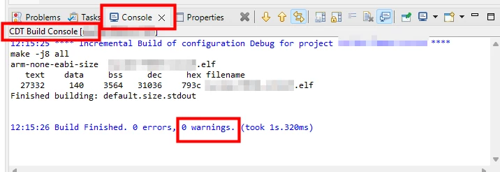

Andrew Neil
Jun 18, 2026 11:18 AM UTC

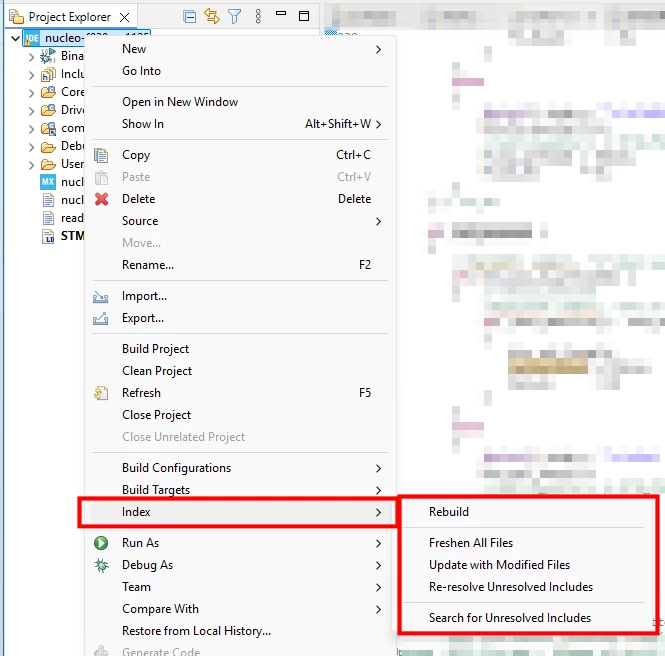

It’s in the pop-up when you right-click the Project in the Project Explorer:
Genuine compiler warnings would appear in the build output in the Console window, and would be included in the count at the end of the build:

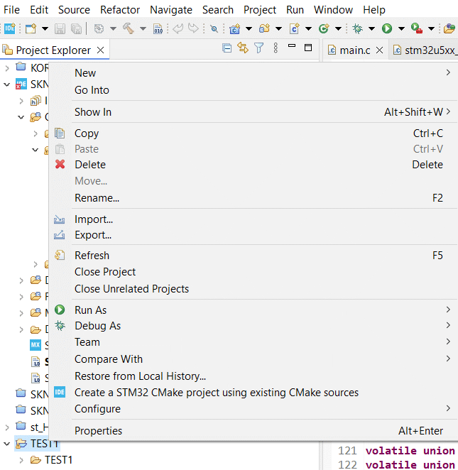

There are no such button in my test program (freshly created in new MX and IDE):
So I missed that it was in my original project.
I must doing something wrong when creating project in new version of MX and IDE. My mistake.

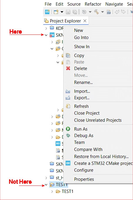

You need to right-click on the Project name.
In that screenshot, you have the ‘TEST1’ subfolder selected.
AmidaAuthor
Jun 18, 2026 11:48 AM UTC
In purpose: using this project I discovered that there are no “rebuild index button”. So I don’t searching this button in SKNA project. But it was there. This was my mistake.
