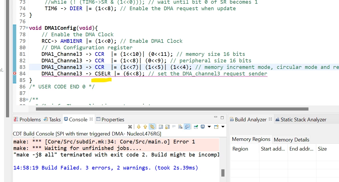

Missing register definition when using DMA1_Channel3 -> CSELR with nucleo STM32L476RG
As reported in the picture attached, an error occurs while trying to edit the CSELR register of the DMA. It seems to lack of the definitions of several register...how can i solve it?
I am using NucleoSTM32L476RG and STM32IDE

Channel selection is done in the CSELR register which is not a per-channel register. So DMA1_CSELR->CSELR. A bit awkward.
https://raw.githubusercontent.com/STMicroelectronics/STM32CubeL4/master/Drivers/CMSIS/Device/ST/STM32L4xx/Include/stm32l476xx.h
