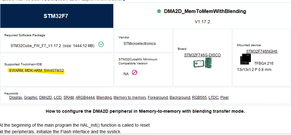

when i import an example from FW package, i got this message.
i have no idea what "nature" is, how could i solve this error?
thanks for your support !

@STTwo-32 thanks for your reply.
I found the example I'm going to use is not support STM32cubeIDE.
maybe the "nature" problem is because of this issue?
In addition, could you explain the different between STM32CubeMX and STM32CubeIDE?
I can create STM32 project by both of them, but I don't know the different.

This is example project in the Cube library, created with some other version of Eclipse. It needs conversion. Do not open it directly in CubeIDE. Do: Import... Example project.

it works! thanks for the user manual @STTwo-32 provided and @Pavel A. also helps me to get the key point.
thank you very much.

by the way, I can build and upload the code to the stm32, but the "nature" problem still there.
every time I import an example, the warning pop up. But it seems no effect on my project(?
Pavel A.
Aug 31, 2024 9:14 PM UTC
If your project builds successfully, you can delete from the .project file <natures> section  the lines that cause warnings (that contain something ....fr)
