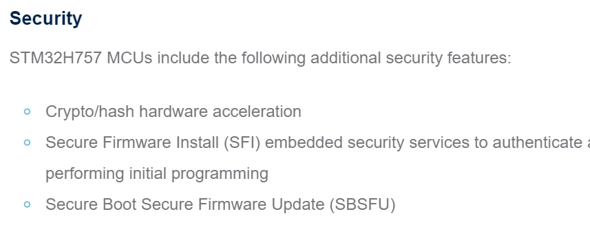

Didn't compare both datasheet, I will assume the memory map is the same between the two chips, only the crypto related IPs are missing in the H747.
Are there specific memory reserved for :
_legacyfs_online_stmicro_images_0693W00000dJyr4QAC.pngOtherwise, as said above, how did you change your project from the 757 to the 747 ? Which toolchain are you using ?
