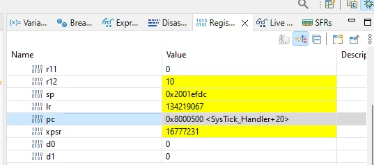

meaning of register view data
can someone please tell me what the +20 means from the General Register view
    0x8000500 <SysTick_Handler+20>
Thanks in advance
    1 reply
    December 7, 2023
    It means the current value of the PC register is 20 bytes after the start of SysTick_Handler. In other words, your current location is likely within the SysTick_Handler function.
