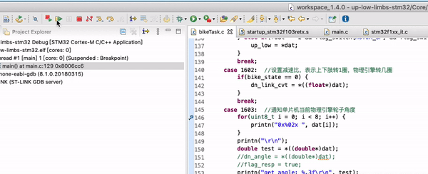

MCU stuck when convert point to double
There is a array:
uint8_t dat[8] = {0xcd, 0xcc, 0xcc, 0xcc, 0xcc, 0xdc, 0x5e, 0x40};
It means a double variable data in memery. The value is 123.45.
This code can be run in my computer:
int main(int argc, char *argv[])
  uint8_t dat[] = {0xcd, 0xcc, 0xcc, 0xcc, 0xcc, 0xdc, 0x5e, 0x40};
  double test = *((double*)dat);
  printf("%.3f\r\n", test);
  return 0;
It will put: 123.450
But on stm32f103rct6. It will stuck when I run this:
But use float will not stuck:
 float test = *((float*)dat);
So, how can I convert memery to double rightly on stm32f103? (I use stm32cubeide)
Thanks!

waclawek.jan
Mar 23, 2021 6:25 AM UTC
How do you know it sticks exactly on that line which performs the conversion?
What does "stuck"exactly mean? Hardfault?
Single-step in debugger disasm view and note which instruction causes it to go to hardfault if that was the case.
nicekwell
nicekwellAuthor
Mar 23, 2021 7:01 AM UTC
It is a hardfault. ​
waclawek.jan
Mar 23, 2021 9:16 PM UTC
Single step in disassembler view, to view which instruction caused the hardfault and what was the content of registers at that moment.
A wild guess, compiler used LDRD wich requires that the array be 64-bit aligned.

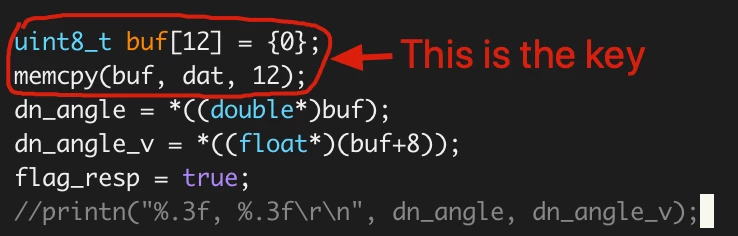

Piranha
PiranhaBest answer
Principal III
Mar 24, 2021 11:41 AM UTC
As Jan said, most likely the problem is the lack of proper alignment. That can be solved by making a buffer to be of a double type. Or even better by implementing a union, which forces the alignment to the largest element and also seamlessly converts the data.
nicekwell
nicekwellAuthor
Mar 24, 2021 12:17 PM UTC
Thank you! I have solved this problem by making a buffer.
0693W000008xmTpQAI.pngBut I still don't understand why.
'dat' is given by other progress. I'v printed and checked the content is right. But I'll get hardfault.
'buf' is copied from 'dat'. And it works fine.
Piranha
Principal III
Mar 24, 2021 1:52 PM UTC
Copying one uint8_t array to another array of the same type will not solve anything. You will have to learn about alignment and unions. :) But you can start with an example from there:
https://stackoverflow.com/questions/8072238/decomposition-of-double-precision-float-into-bytes-using-union-in-c
