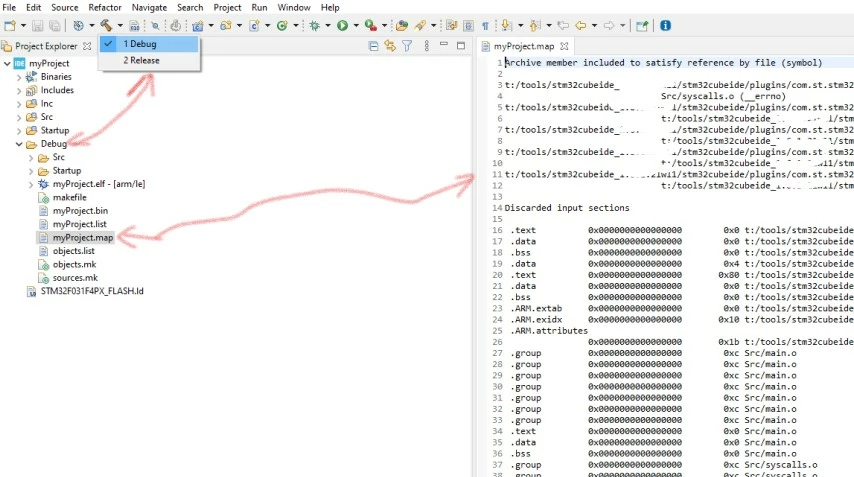

Not using CubeIDE, but the GNU/GCC .MAP file should list globals and addresses in RAM

Building a build configuration 'X' is creating a 'X' folder within your project repository. Such exposes all build artifacts including map file
