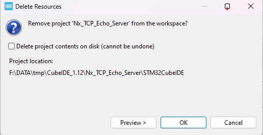

@ANauz.1 With all respect and sympathy, IMHO this was an important bit of experience with Eclipse and software in general. When you delete a project in Eclipse, it won't immediately nuke it! It will show a dialog like this:
A savvy user will think twice before checking in the "delete contents on disk' box... then leave it unchecked. Then  manually view & delete the files in explorer.  Reckless or curious folks will get what they deserve.
Also, talking about being professional - how about backups or version control for your valuable stuff? And er... manners?
Also, your scenario is not quite correct. With CubeIDE you create a CMake project. While CubeMX v. 6.10 (latest) cannot create CMake, it creates other types of projects (Eclipse, IAR etc. or plain makefile). These types of projects have different directory layouts.
/* EDIT */
Back to deleting a project: the preview dialog indeed is useless - it should list the items to be deleted. At least say "everything in that dir". The upstream eclipse should deal with this.

I was try to find a solution for this behavior with our developers; but not much could be done from CubeIDE side.
In fact this is related to the way ECLIPSE manage the folders and projects.
Therefore, I believe that the best way is to create project with CubeIDE and uncheck the "Generate under root". This way if you delete the project in CubeIDE, only the STM32CUbeIDE folder will be deleted.
