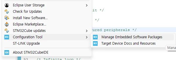

 However, this is my actual screen.
 I am sure I have chosen the board correctly.

It seems that the STM32 firmware is not installed. Therefore, I recommend that you set the Network Connection and log to your ST account before generating the code.
I suggest that you take a look at UM2609 section 1.2.3 STM32CubeIDE user authentication.

You're probably not importing the project correctly or there are some project configurations missing. What does the project tree look like in File Explorer?

You have no source files so that is why nothing shows in the project tree

You need to describe how you're creating a project and which uC

I had to install the software pack as shown in the picture.
Thank you very much.
