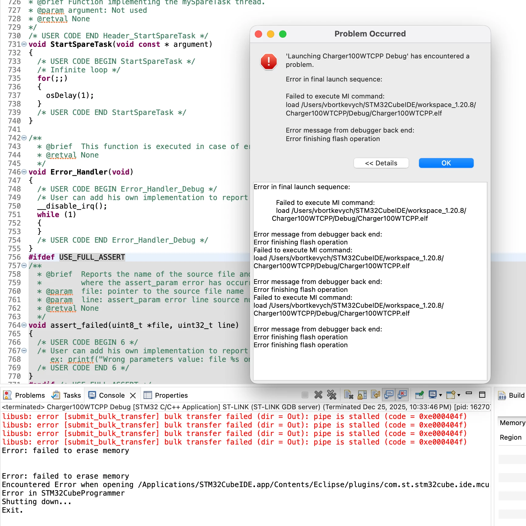

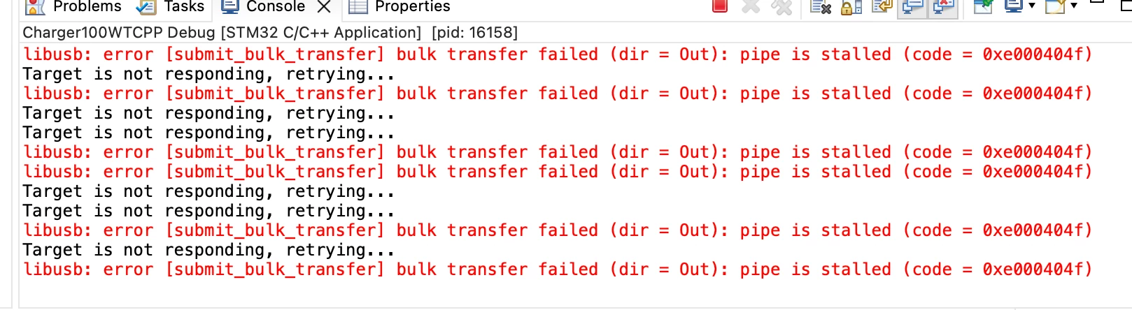

MacOS Tahoe can't flash MCU
  • December 26, 2025
  • 3 replies
  • 506 views
I recently switched to a new Macbook os Tahoe. I can't flash MCU. I see some errors pop. CubeMX detects ST link V3 minie, but can't flash it. Same come with the ST link upgrade. The old Mac with the Sequoia can do the job. Any ideas please ?

UPD. So it looks like Tahoe glitch nothing to deal with V3 mini.
