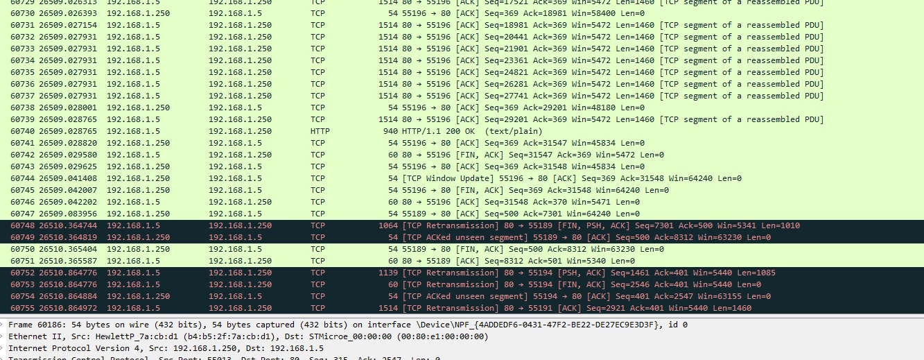

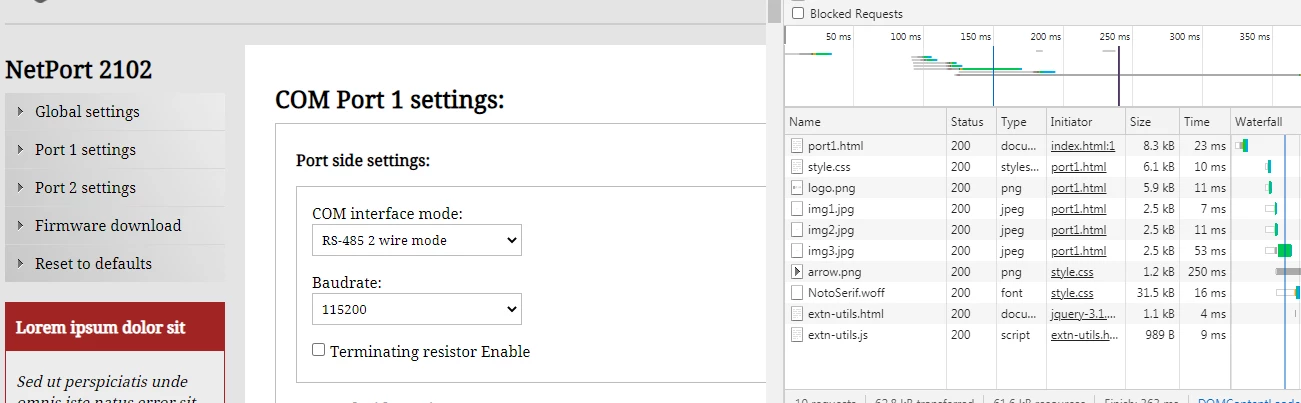

Hello, dear colleagues!
I'm trying to build http server based on LWIP on Nucleo F429 board. An example from Cube repository works fine, also with my custom http data and paths, which I have included in example project. But, another CubeIDE generated project with same or, even, greater settings in lwipopts.h works much slower and generate lot of packet retransmittions. I have checked all interrupts priorities in both projects, priorities of tasks, turn on lwip_stats, which shown absence of errors and so on. It's enough of memory and buffers. But have no result. There is the same problem on F746 DISCO. Please, indicate me direction for my eyes. Thank you in advance.0693W000008xyvvQAA.png 0693W000008xyzdQAA.png

The same problem has been detected with STM32F427.
LWIP Stack doesn't work properly in STM32Cube F4 Package Version 1.26.1 with CubeMX Version 6.2.1.
With STM32Cube F4 Version 1.25.2 with CubeMX 6.1.1 and 6.1.2 everything works fine!
My dynamic html page (chunked) 60kb in total (with font, images and scripts) loading 200-250ms without any retransmits.
