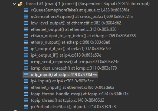

Just wanted to start of with mentioning that i've read and tried the fixes  provided by @Piranha. I've tried the "Semaphore fix" but it has not helped, i still get stuck on the following row in the function xQueueSemaphoreTake (queue.c). uxItemSize does not equal zero and the CPU gets stuck/locks at that line. uxItemSize always equals 2779096485 when it gets stuck, regardless if its after 1 ping or after 5000 pings .
configASSERT( pxQueue->uxItemSize == 0 );
The interesting thing is that i'm able to ping the processor a few dozen times to a few thousand times before that processor locks.

2779096485 = 0xA5A5A5A5, which looks suspiciously like something that fills memory (stack???) to see if it has been accessed.  Which means somehow pQueue has been corrupted.  Perhaps a stack overflow somewhere?  Turn on FreeRTOS stack overflow checking (CHECK_FOR_STACK_OVERFLOW, under "Config Paramters"->"Hook function related definitions", at least in older CubeMX versions).
When you halt the debugger when the code is stuck - what does the stack trace show?

I enabled the stack overflow detection with option 1 & 2. It does not seem to have triggered, it should call vApplicationStackOverflowHook if an overflow occurs?
Below is the stack trace when the debugger halted when the processor gets stuck.

Yes, the FreeRTOS scheduler should call vApplicationStackOverflowHook() when it detects an overflow.
This is definitely corrupted memory somewhere.  0xa5a5a5a5 is the value that FreeRTOS uses to fill the stack areas in order to check for overflow.  So something is corrupting the the "pxQueue" pointer before it gets passed to xQueueSemaphoreTake().
I'm not running the newer Ethernet/LwIP in CubeF4 ver 1.27, so I can't tell you WHICH semaphore or mutex low_level_output() is trying to acquire (the older versions do not use a semaphore/mutex there).  Start your search there.  See if you can find out who or what is clobbering that mutex/semaphore structure.

I don't know how i missed it but vApplicationStackOverflowHook() is called when calling MX_LWIP_Init(). An overflow occurs in the EthIf task, i increased it by 4x for testing purposes and it seems to work. I've pinged and scanned the device continuously for about 5 hours now without a single lockup.
